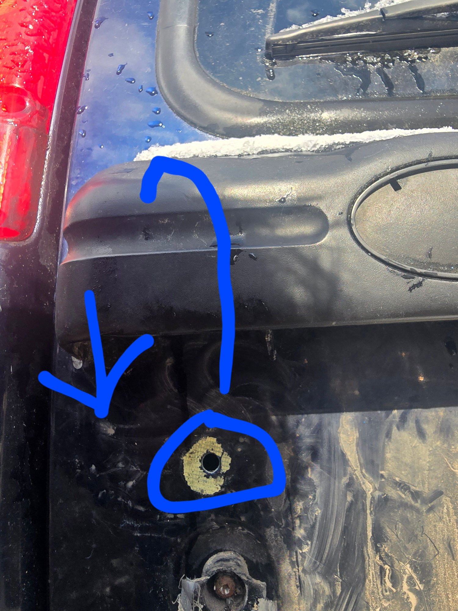

For anyone trying to get into a locked land rover all you need is a screwdriver and a clothes hanger. Under the rear license plate holder are two little holes. You can actually thread a clothes hanger into the leftmost hole and pull down the locking mechanism on the rear cargo door handle. This took about 15 minutes of trial and error but I was able to hook the latch without much difficulty. I hope this helps others out there who get locked out and may save yourself a broken key or window.

Will send oics of hole under license plate tomorrow as i got it open during the night. I will add the holes were under two circular stickers.

I
Attached an image of the hole i inserted a hanger into for whom it may help avoid the situation im in. Insert a close hanger into the slot, hook the lock linkage and pull down and it'll unlock. Save you a lot of 💰

In all of my years of owning Discos (and like ... alot of Discos) I have never heard of unlocking a Disco2 this way. So kudos for this !

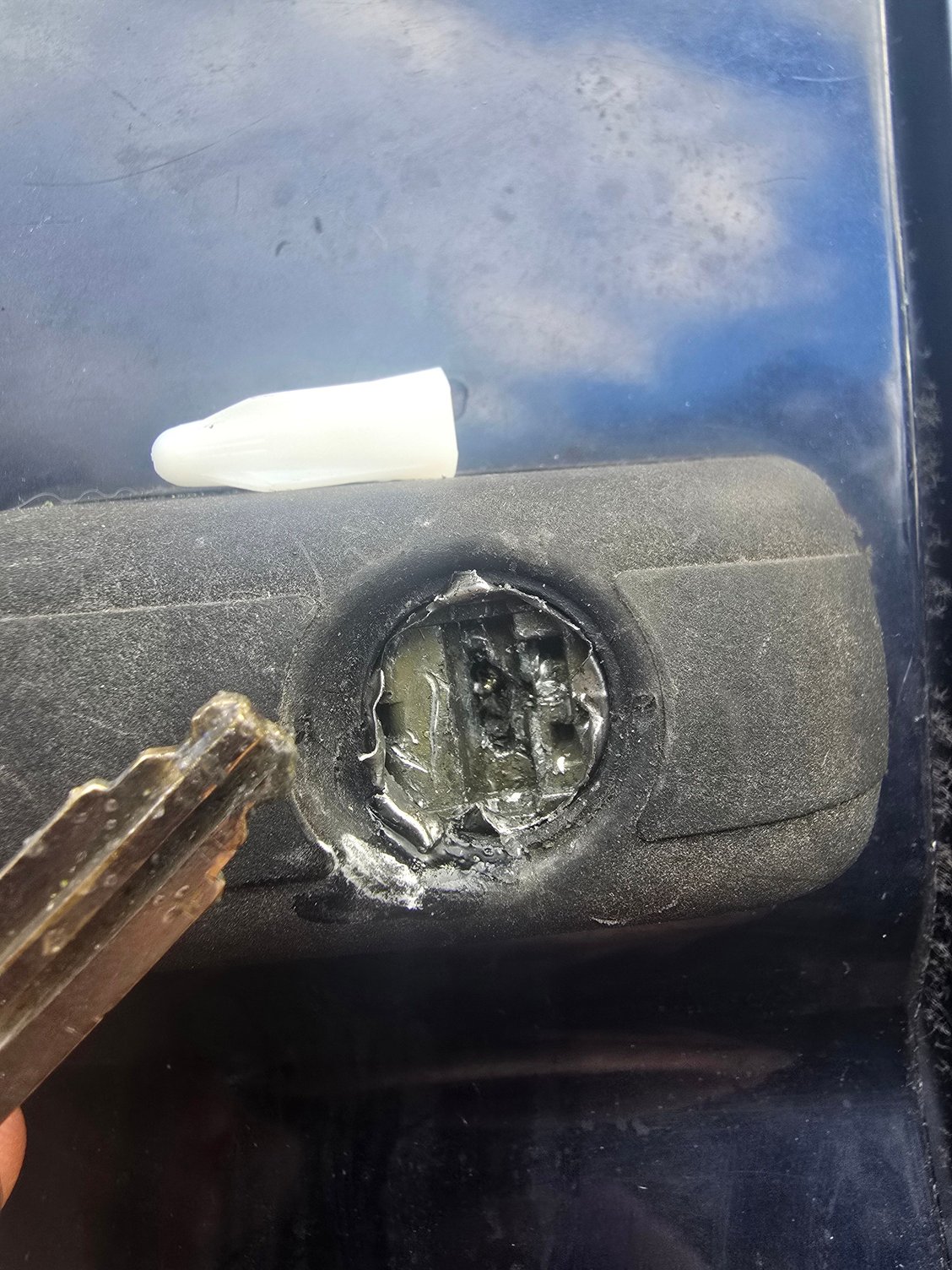

Visual reference of what I'm trying to get out here. Yes I know my door handle is FUBAR thanks to this

I would remove the door handle from the car. It's been a minute since I had mine out, but I seem to recall that once it is out you can access the keyway from the back and should be able to just push the borked key out.
Then you can take the handle to a locksmith and avoid the mobile fee. The local shop near me charged, I think, $50 to make a key for it. It was less than $100.

I actually ordered a new ignition chamber and door lock that comes with an FOB key since I've never had the FOB and my driver door handle is now broken as hell. I ordered 3 replacement x239 keys to be cut with the new parts.
Only thing left now is to see if it's possible to program the new FOB to the truck. I'll be back on the road again in a week. Thanks everyone for the feedback and advice!
