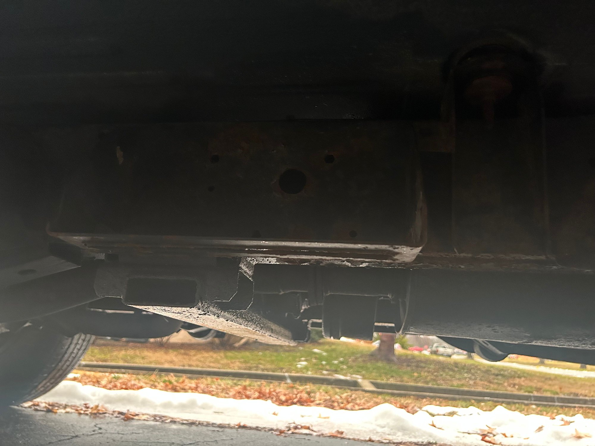

Looking at a 2004 D2, frame rust pics and need your thoughts

The owner sent me a few pics and it definitely has rust, pics aren’t the best but what do you all think?

Not the best pics but I don't see anything I would be worried about...

one of the places you need to check is in the inside of the frame next to the fuel tank thats the place a lot rust out

Looks fine, that is that if you clean it up and treat it, you would be fine for a while. There are plenty of threads on different treatments, from used motor oil to rust converter, etc Stay away from bedliner.
