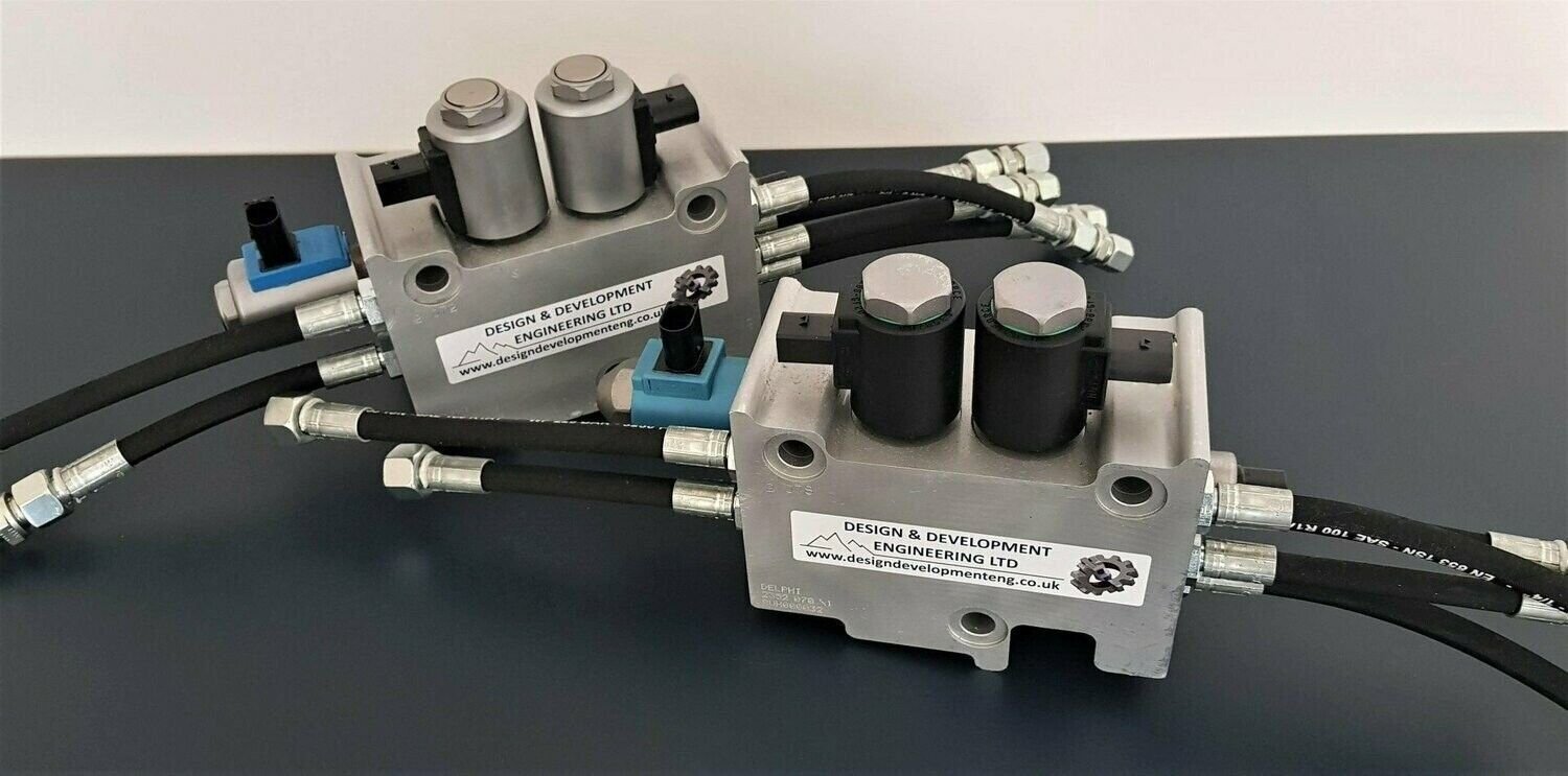

Mine was leaking and it was determined (by an excellent LR independent shop) that the aluminum valve block and the steel lines corroded badly with the aluminum too badly pitted for the seals to work. I found a company in the UK that sold rebuilt/remanufactured ACE blocks. https://www.designdevelopmenteng.co....ded-p389433934
I installed it and mine works great!! It has all new parts, valves, electrics and fittings. Just carefully measure and cut your existing steel lines, mount and install the new one.
Works great!

Well I'm hoping the new seals will do the job, the pipes are in pretty good nick as is the valve block. Even if I can get more time out of it to save up to do what you've done I'll be happy.
