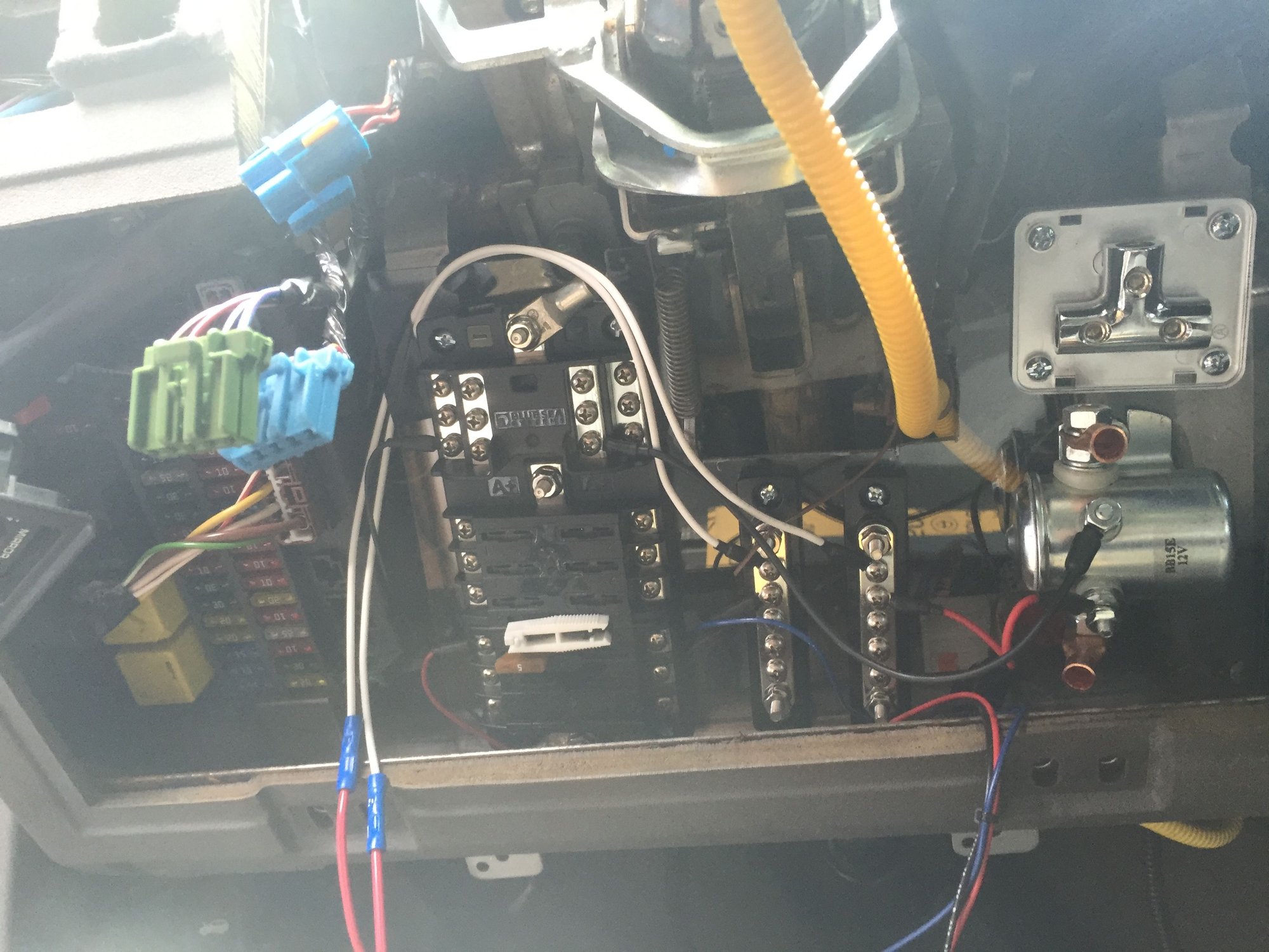

Jeff Blake's Avatar
Joined: May 2016
Posts: 1,617
Likes: 184
From: Lake Tahoe
Auber gauges
I think I tapped into the headlights for the dimmer
Glowshift oil filter sandwich adapter for the oil pressure and temp
Glowshift water temp sender for the coolant temp

That's pretty cool, super clean. What's the fourth gauge for?

haven't hooked up the amber one yet. Probably voltage, or transmission temp if I can find a good way to tap in
