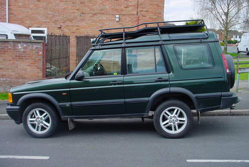

It will only be short at the back, the front has to go in the same place because of the design
So you can "see" what it will be like, heres a piccy for you

thanx for the pic. much appreciated.
now how did it pass MOT with the suspension wackadoo? lol or is that saggin air...

Its the rear that has been raised to the offroad mode for the piccy i assume
