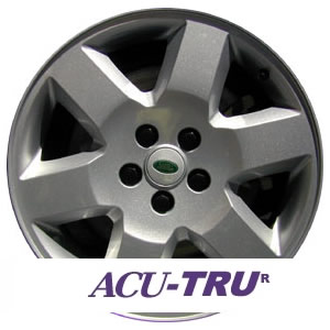

well I have been running these on my disco for the last 30k with no adapters I guess I'm screwed....
