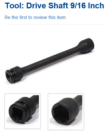

1. M20, IDK the pitch. Same NyLoc Nut front/rear Part #: NY120041L
2. NyLoc Nuts are the same front/rear Part #NZ606041L > 3/8" UNF
3. Spanner is 9/16", I find an open end/box wrench to work well too. The "prop shaft tool" can also be useful.
Thanks you guys, it's the M20 shaft bolt I am interested in as I have the 1/2" drive special tool for the 4# flange bolts. The M20 ID is good for me though as I'm making a slide hammer tool to remove the front output bearing complete with the shaft as the bearing is a bit slack and moving circa 0.010" up and down. I think some torch heat may be required also to warm the transfer casing. I'll be doing a total LT230 rebuild sometime soon.
