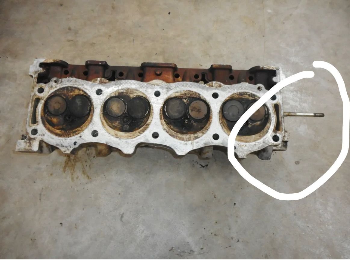

I’m having a heck of a time trying to get the stud out of the other head.
Assuming I can’t get it out—though I’ll keep trying—I’m trying to find that part to but another and I’m having no luck. Anyone have a source or a part number or anything?

What stud are you talking about? Pic needed

Try a good quality set of vice grips or channel locks on the non-threaded part of the stud.
Otherwise you may just look at getting a piece of metric all thread and cutting one the correct length.
I thought about that but there’s a shoulder on that stud and I’m assuming it’s necessary to have that.
