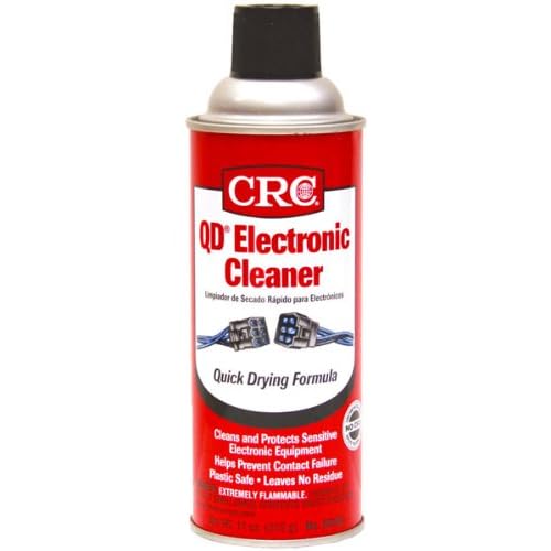

Not true. Mine was throwing codes 20K ago. I cleaned it and it has been good ever since. The key is to use the right stuff and make sure it is dry before re-installation. I used CRC Electrical Contact Cleaner - see below...
Besides, if the MAF is bad, what harm can it do to clean it. Worse case scenario you are out the $6 for the can of cleaner.
