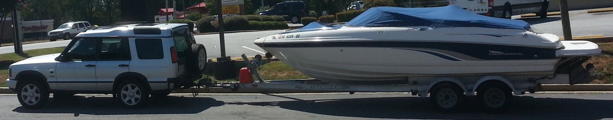

I have pulled multiple Discos home with my Discos, once over a steep mountain pass (that one required stopping to let the engine cool). You definitely want a braked trailer at that weight, but most trailers rated for that weight will be braked. I pulled my 3600 lb boat frequently. All of them get a little squirrely over 65mph, I recommend that as max speed. Trailer pulling is definitely the situation where you would be better off with a rear air setup, but few of them still have that. Make no mistake, does not pull like my Duramax or another full size long bed V8 truck, but they are ready to go for frequent towing.
