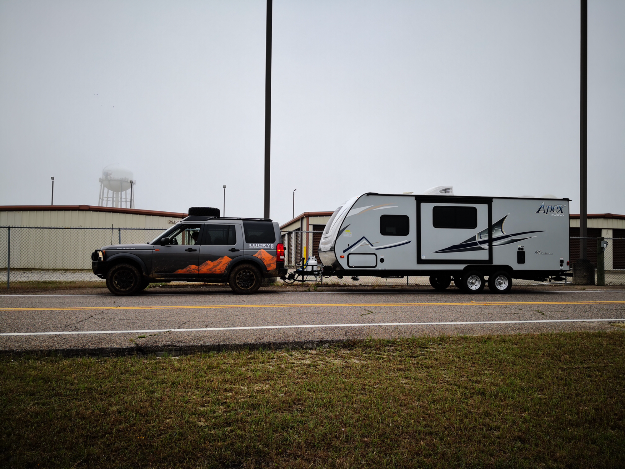

Weight won't be the issue at 4-5000 lbs the big flat wind grabbing slab sides of that thing will be. Tail wagging the dog is the concern. I have towed 6k behind a 1991 lifed Range Rover Classic on 33's it wasn't fast but she did the job just fine. That however was a car hauler with a ML350 on it.
You didn't say how long of a travel trailer but one highway run with my LR3 which is bigger heavier and more powerful had me buying an Excursion.
This is the specs on the trailer https://coachmenrv.com/travel-traile...no/208BHS/4011
