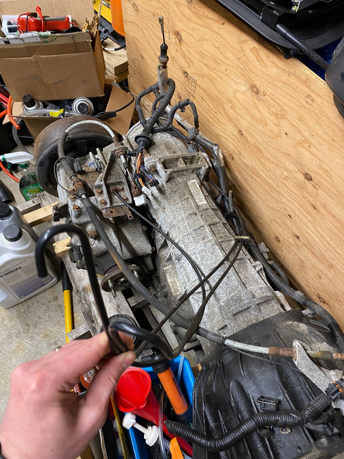

Here is a picture from a spare transmission that I have. What’s in my hand is what normally would be zip tied to the lift bracket on the rear of the passenger side head. The one with the hook goes back to the transfer case and the loop goes back to the side of the transmission. When they melt it might look like you have 3 tubes instead of two.
