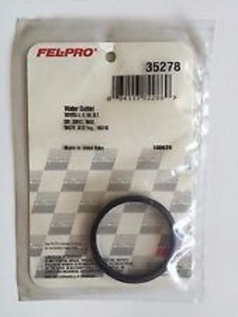

I had 2 different Meziere stat housings (WN0071) leak on 2 different trucks. Being that the threads are parallel and not tapered pipe (NPT), Teflon tape or paste sealant won't/can't work long run. The problem was the gasket. I tried a Fel-Pro #35278 (it's thicker) and it sealed like a champ. You can get the Fel-Pro or one like it at any NAPA. Good Luck!
