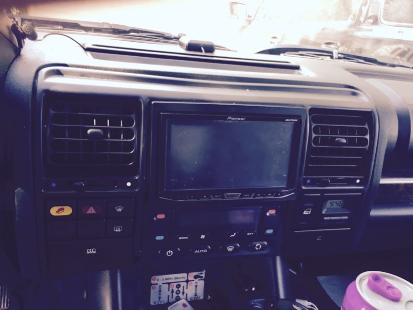

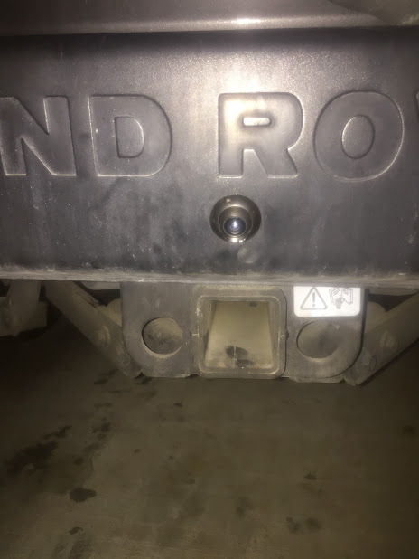

I installed a rear view camera that is hooked up to my double-din head unit. With the limited sight, because of the back seats and tire, I felt it was needed badly. On mine I drilled a hole in the rear bumper, powered it by tapping into the rear power supply right behind the rear seat. Then ran the video cable up where the tail light wiring goes into cabin and under the door sills to the head unit. A lot of people will power the camera by way of reverse lamp, which is fine. My head unit has a wire that hooks up to to reverse signal wire near the inside fuse box that switches view to rear camera. It also has a camera view option to view rear view while driving to check on trailer or whatever(this is the reason I hooked up to switched power instead of reverse lamp). I installed mine where I did because it makes backing up to a trailer a breeze, and It has plenty of viewing area. I attached pic of the camera mounted and the head unit.

That is nice! How do you find the proper DIN adapter for the D2 to whichever unit that you are trying to fit?

Unfortunately, The D2 will only accept a single din head unit, without extensive modification to the center dash fascia. I got one off Ebay to modify, got a Pioneer double din install kit from Staples. I used a hacksaw blade to cut the area above the A/C controls and adhered the double din cage to the cut-out. Then cut out the area below where the A/C controls were to lower the controls.
