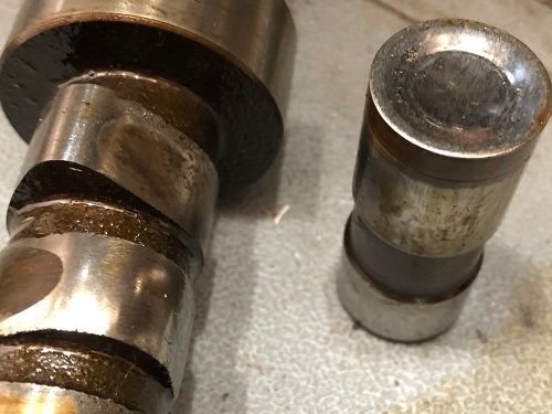

Originally Posted by Thomas Alberts
I have repaired the damaged knock sensor wire and replaced the O2 Sensors.
All codes are gone except still has PO301 cylinder 1 misfire. It has always just been Cylinder 1, never random or any other cylinders. What can it be?

Following up, mine turned out to be a flat cam lobe.
