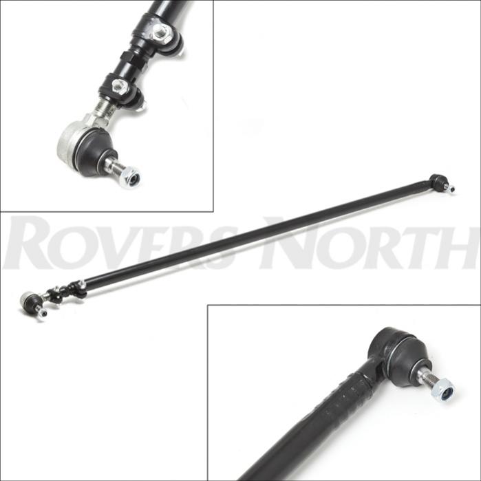

ROD & FIXED BALL JOINT DISCOVERY II TRACK ROD, RNH074, QFS000040 - Land Rover Parts | Rovers North
This what the factory rod looks like with a fixed joint, as I said most of the replacements are built to have removable ends.
