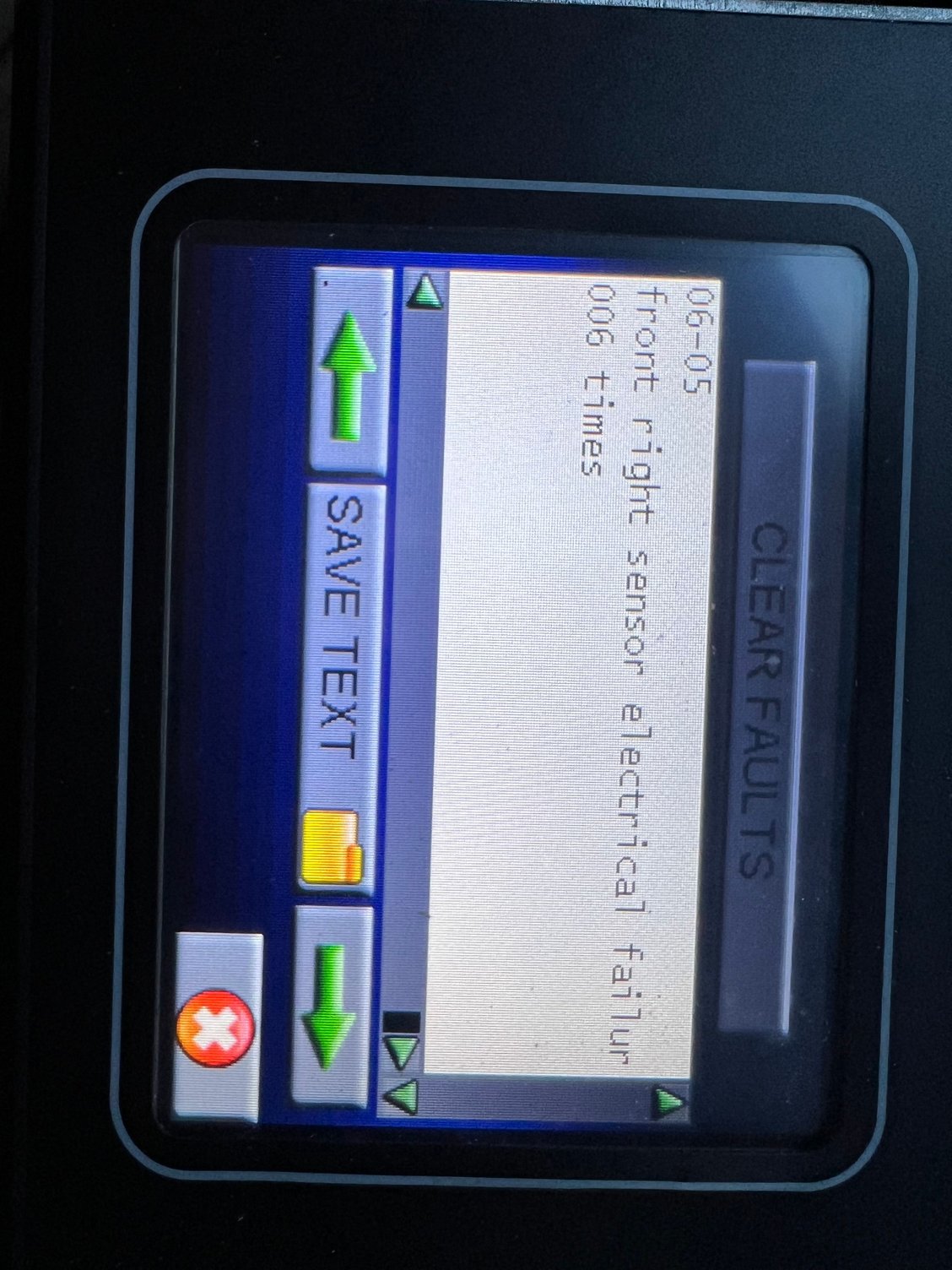

slabs says “front right sensor, electrical failure”.

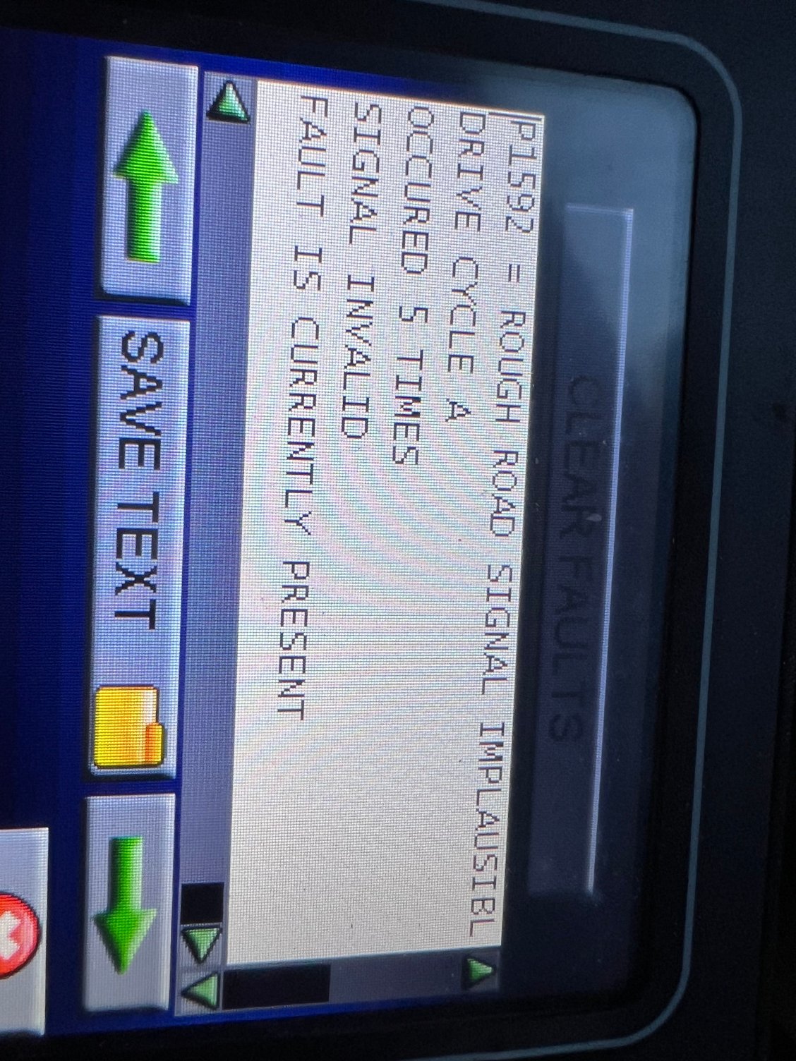

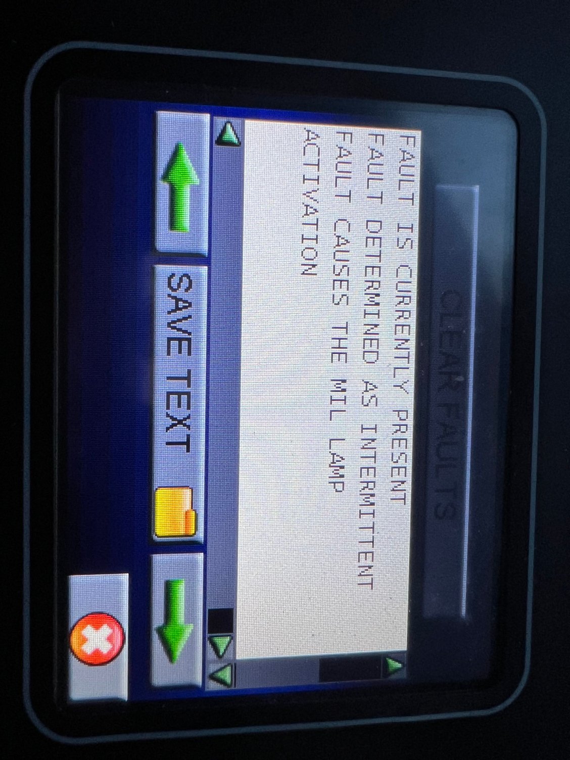

motronic says “p1592 rough road signal implausible”
Replaced both front hubs/sensors fairly recently, (within 18 months) chasing this issue, which did seem to solve it for a while.

My guess is intermittent signal. I have a couple scanners that plot the sensor outputs which is a digital square wave. Regardless of having one I would start by checking the sensor connections, then swap sensors left to right, then swap ECU input left to right (will require depinning the connector).

P1592 is a generic code that seems to pop when there's an ABS code. It's not telling you anything other than to look at the codes for the ABS system.

They are all in one connector, so you would need to de-pin the connectors out of the plug to move them.
