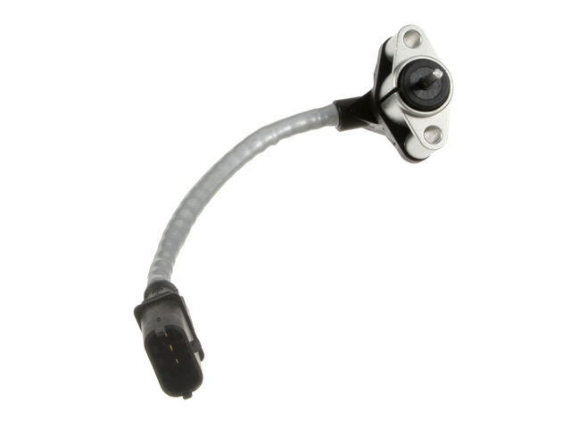

Googling I see that the Discovery 2 has a camshaft position sensor also.
Old Aug 27, 2012 | 10:04 PM
jfall's Avatar
Joined: Mar 2012
Posts: 3,171
Likes: 45

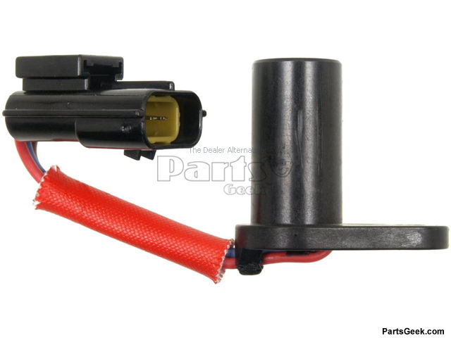

Here is the crankshaft position sensor - which you replaced..
So if the camshaft sensor is dead - I bet this is fatal to the ECU getting the timing correct.
Yes, I bet this is your problem.
Probably the camshaft sensor figures out where the camshaft is - which determines WHAT cylinder to fire.
The crankshaft sensor determines WHEN to fire the spark..
So, in essence, your engine is "LOST" as it has spark, but is not firing the spark to the correct cylinder.
I bet horseshoes to hand grenades this is it.
Here is the crank sensor you replaced:

Our engines will run with a failed cam sensor, its only function is to show the ECU top dead center which it then uses to set the timing for the injectors.
My money is on a failed cam or timing chain and would suggest a compression test and possibly a leak down test.
