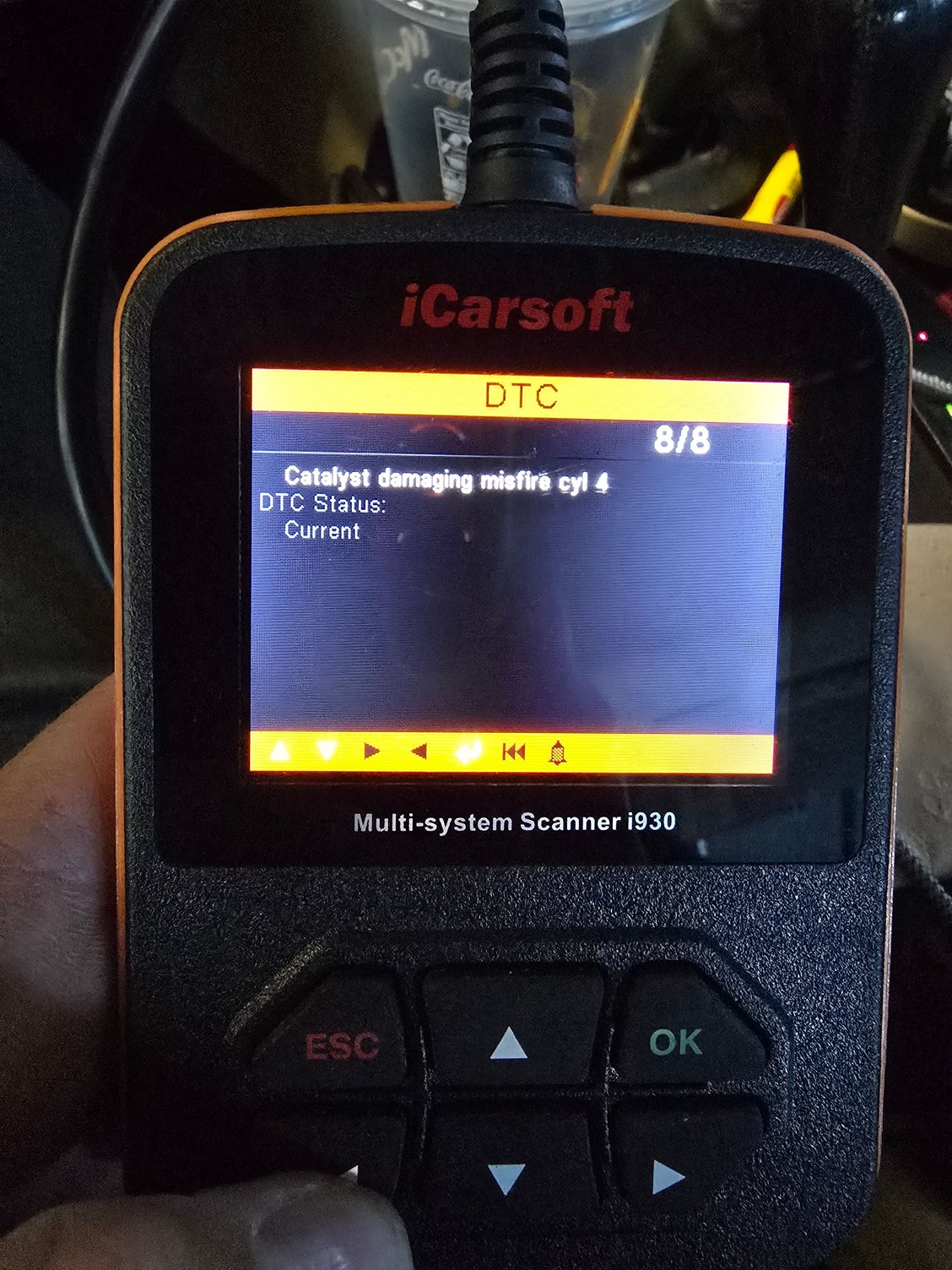

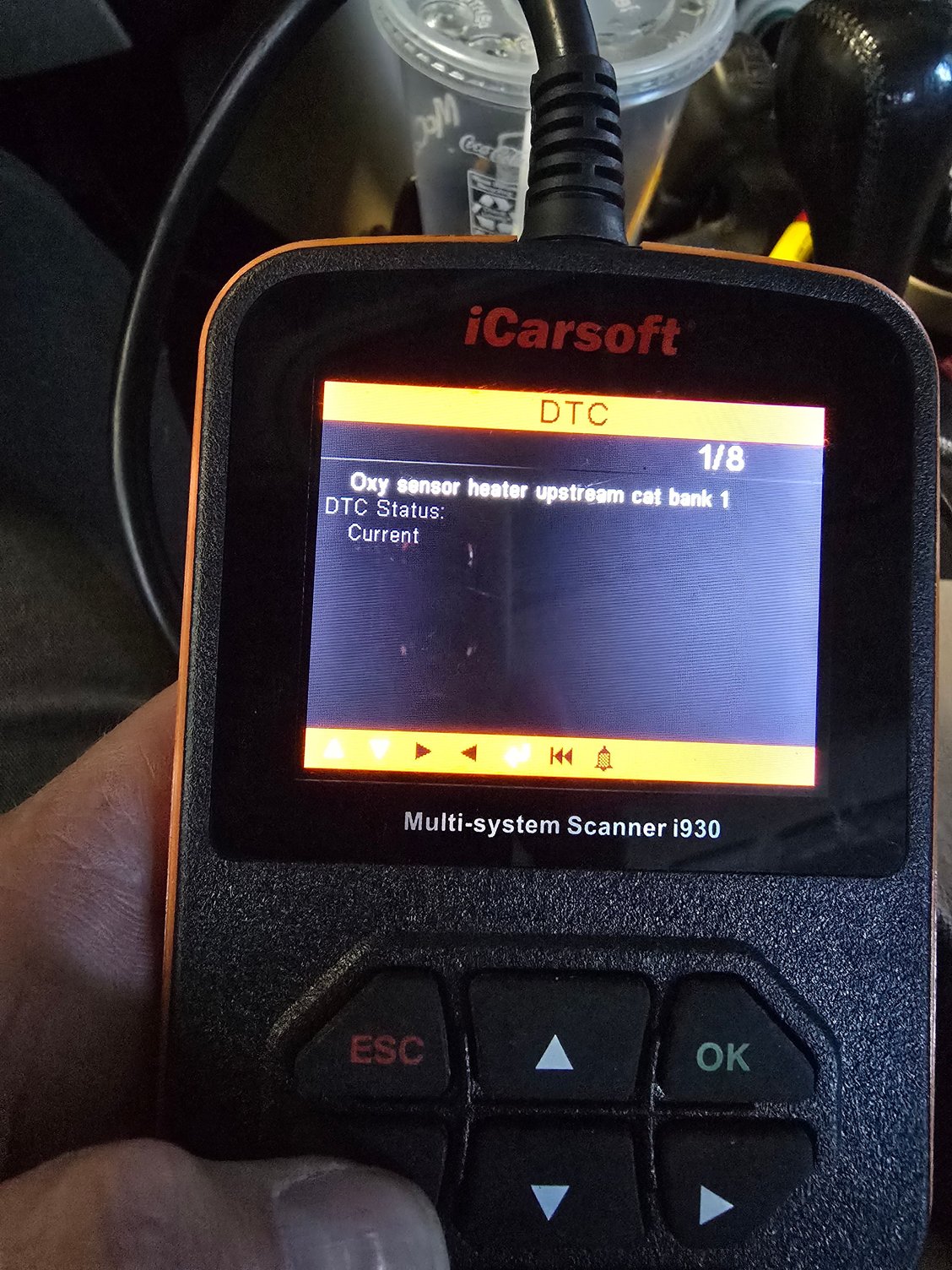

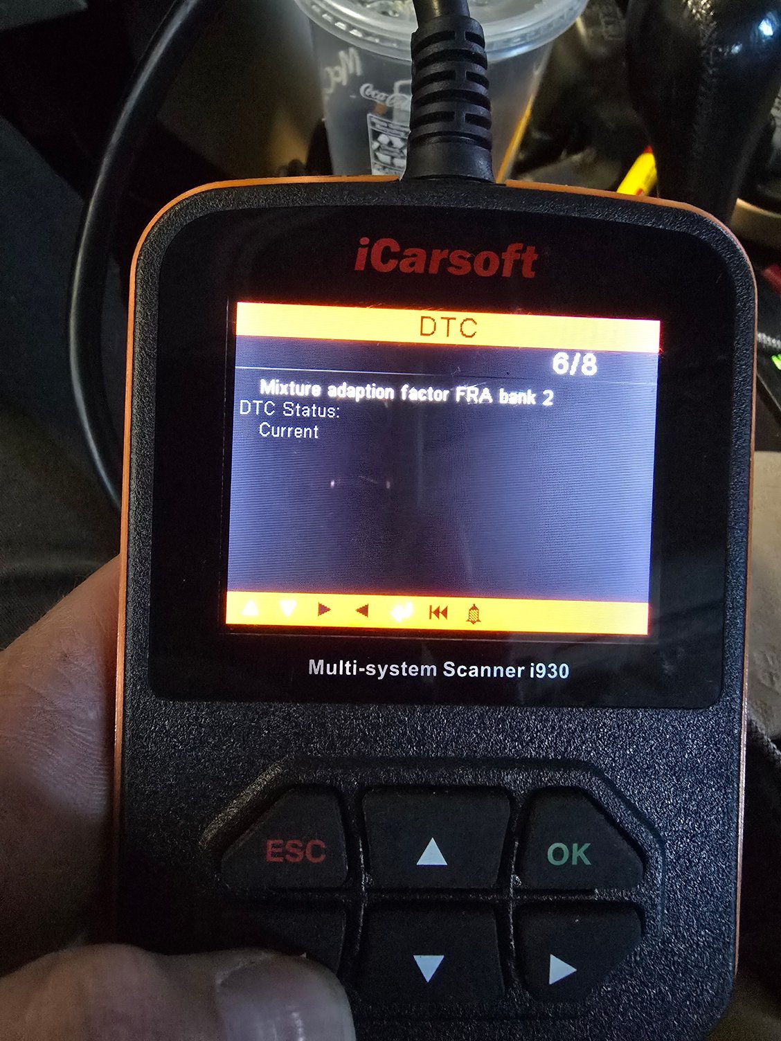

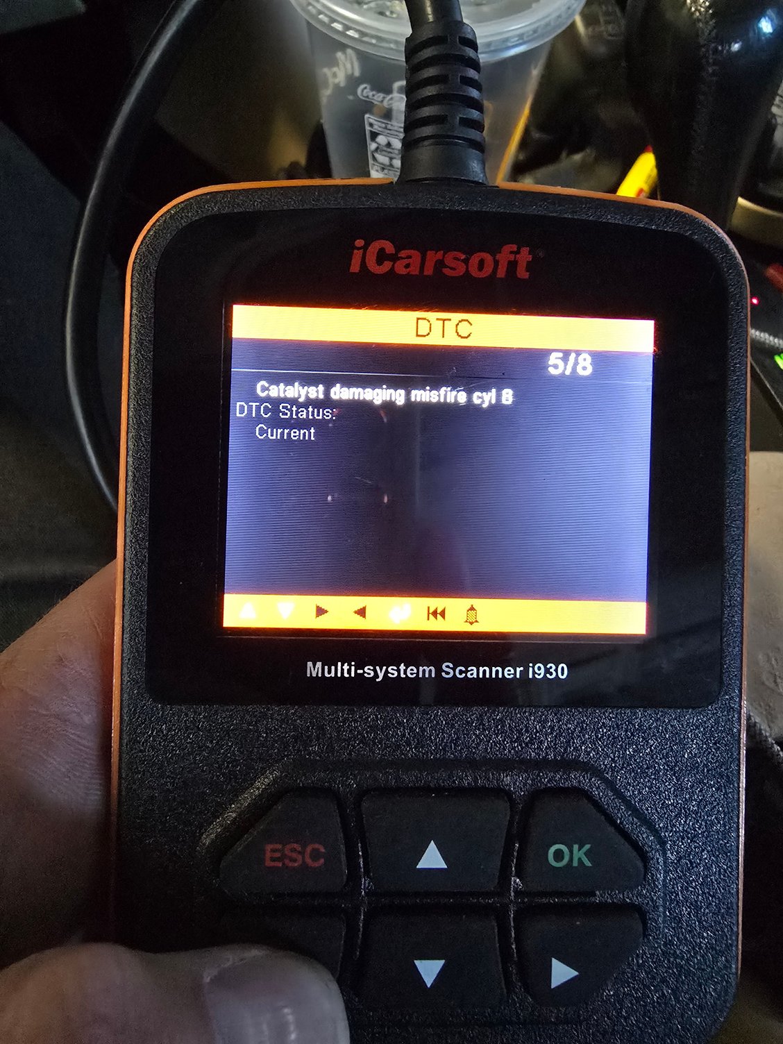

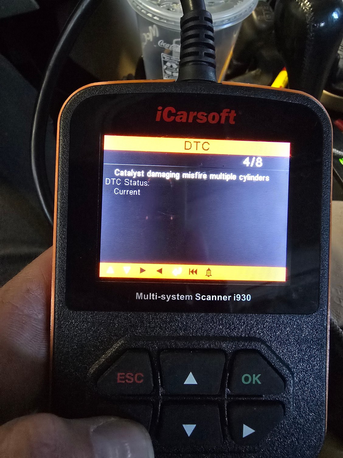

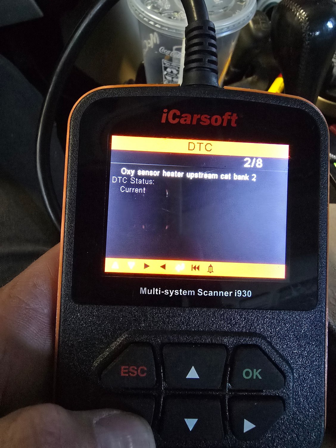

2004 about 140,000 mi. Previous owner allegedly replaced the coil packs and did a tune-up probably 4 or 5 years ago. Runs great and then it random it's suddenly has massive misfires and bleaking check engine. I'll push the gas pedal down it will struggle and then suddenly it will run good for 30 seconds and I'll go back into this misfire limp mode.
If misfire codes for two, four, six, eight and code for catalyst causing damaging multiple misfires.

The only component common to all cylinders on one bank that can cause misfires is the upstream oxygen sensor. No need to replace all four, especially not the downstream, post-cat sensors that have NOTHING to do with engine management.
I recommend buying your replacement O2 sensor locally. Too many stories on this forum about O2s being bad out of the box. Walker recommended, Bosch if you must.

Here is a trick, unplug the upstream 02 sensor. When this is done the ECU goes in to speed density mode and only uses the MAF and rpm for fueling, no 02 sensors. See if your misfire comes back in that condition.
