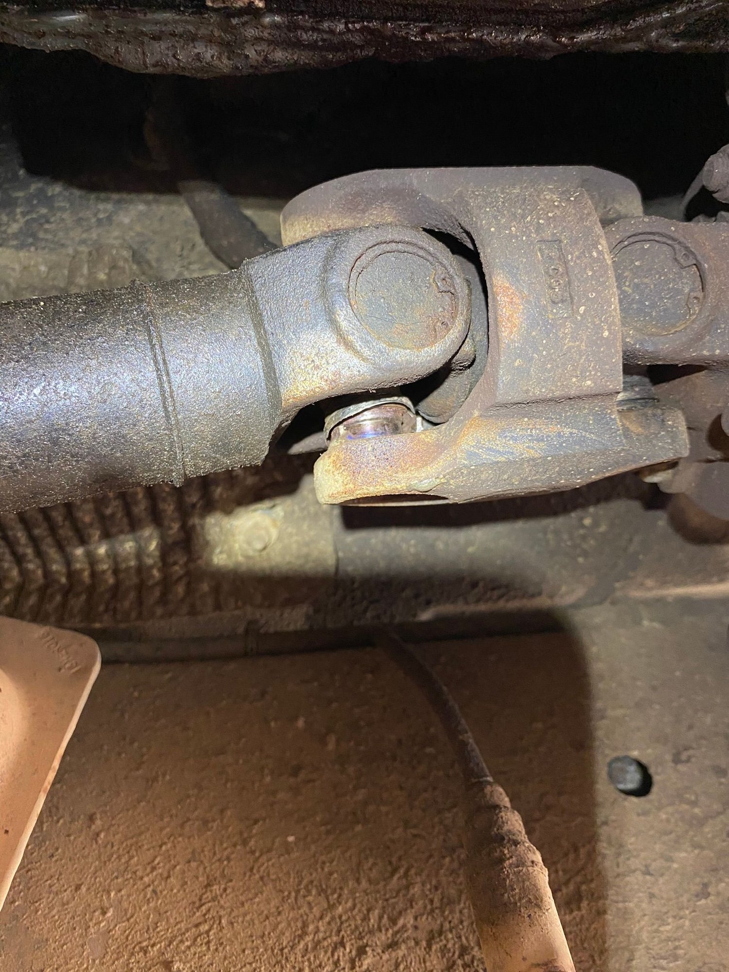

Check your driveshafts people! On the 1200-mile trip I took this thing on a month or so ago, it started vibrating towards the end of the trip, and I parked it for a while for other reasons. I drove it again last week, and the driveshaft started squealing, so I ordered a replacement (dirt cheap eBay one - non-greasable, but for $150 and considering how little I drive this thing I could care less as long as it doesn't vibrate). So, I put it in today, and it's back to being vibration and squeak free. Also, wow was this thing close to coming apart! Another 20 miles and it would have likely self-ejected. Glad everything worked out.
Yeah, that's not good. It basically fell apart in my hand.

glad you caught that. i lost one of my '04s to the front propshaft grenading and taking out the TC and Transmission.
