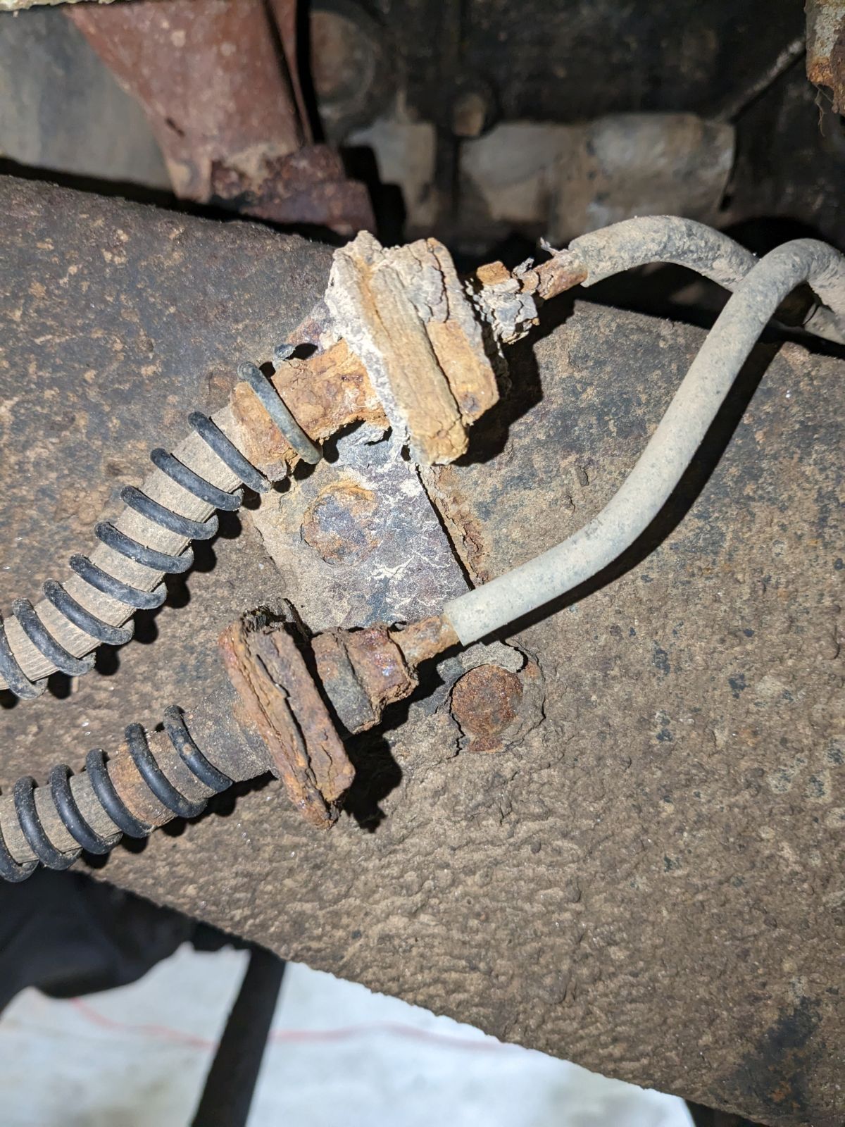

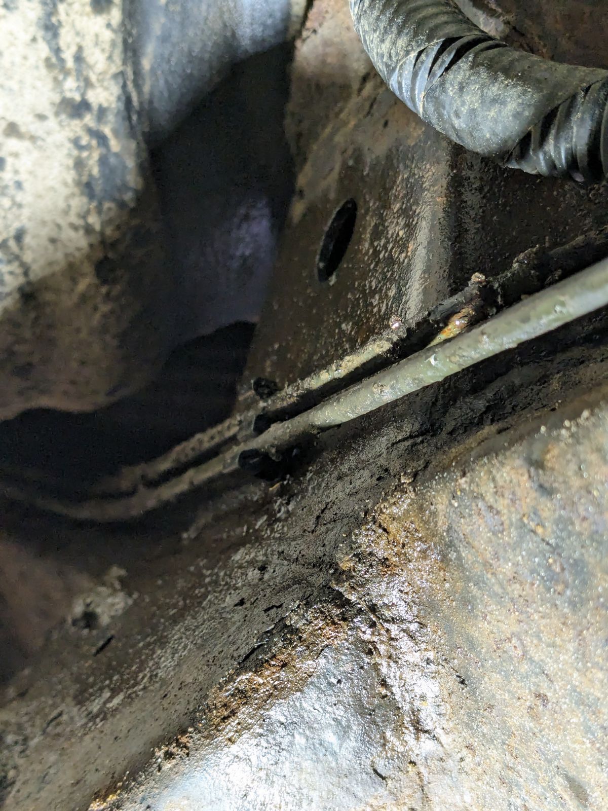

Want to get this thing back on the road, so I finally got a chance to pick this thing up and take a look at the brake lines. It's not very pretty.
Blew the line going to the rear behind the left rear wheel, and the factory connections are looking pretty rough as well. What thread pitch and flare do these lines use? Going to run down to the parts store and get some of that NiCop stuff and redo every line that looks sketchy

Just did all mine (along frame and side to side), I'm in NJ so lines have a death sentence haha. I can see if I have the packages of the fittings I used. Doing the longer hoses next.
