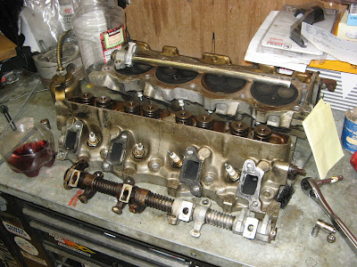

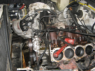

Old May 6, 2010 | 10:11 PM
  #25
audiS4S6's Avatar
Joined: Apr 2010
Posts: 170
From: Elizabethtown, PA
Bigger, for a better look...
notice the rocker shaft, soaked half in Purple Power - cleans stuff good! I will still disassemble but this makes the process a bit less messy.
Don't let this scare you. You will have taken it all apart, you'll now where it goes.

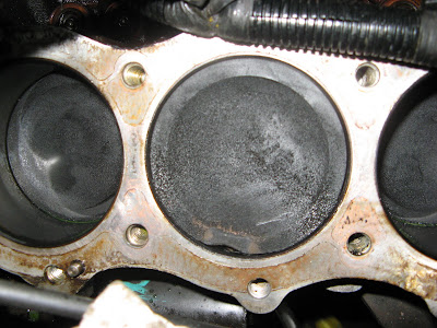

Old May 6, 2010 | 10:17 PM
  #26
audiS4S6's Avatar
Joined: Apr 2010
Posts: 170
Oh, this is what can happen if you had kept driving it.
