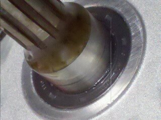

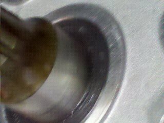

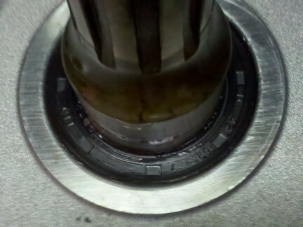

I took a few pictures and wanted to share with everyone, but I don't know how to upload them.
Wait!...I think I got it!
Check these out and tell me how they look. I tried to show the seal...I hope you can see it. This was the cause of the leak.

I can see them, they're a bit blurry... or I'm drunk
