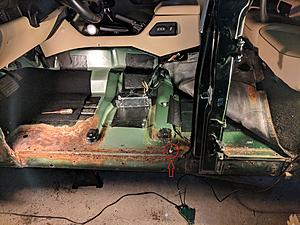

2004 Discovery 2; I am in the process of repairing the front and back door threshholds. I needed to drill out the screws that held the plastic threshholds in place. I went online to find replacement fasteners, but came up empty. Not sure what the technical name is for the part, let alone where to fine it. The part is a small plastic barrel that clips into the frame that can be screwed into ( see photo ). Any assistance in tracking these down would be greatly appreciated. Cheers.

I dont know what it is called, but i would be that Granger sells them.

Technically, they are called push pins.
They come in many sizes.
Auto parts stores have them, but may or may not have the exact size you need.

Yep... Grainger or Fastenal

Fastnel carries the part. They are 1/4" screw grommets with attached 1/4" nylon spacers. $0.79 per. Thank you for the direction.
