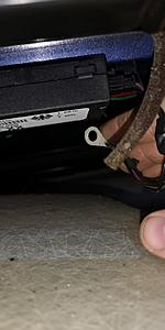

Yes I've attempted both 1515 and 1414 with no luck, I'm now attempting to get to the remote receiver box in case it's anything to do with the earth as I've read somewhere it sometimes can, the only thing I see when looking is this cable that's not attached anywhere.. but I'm not sure where it would go either way

That's usually for a ground but I won't swear by it.
