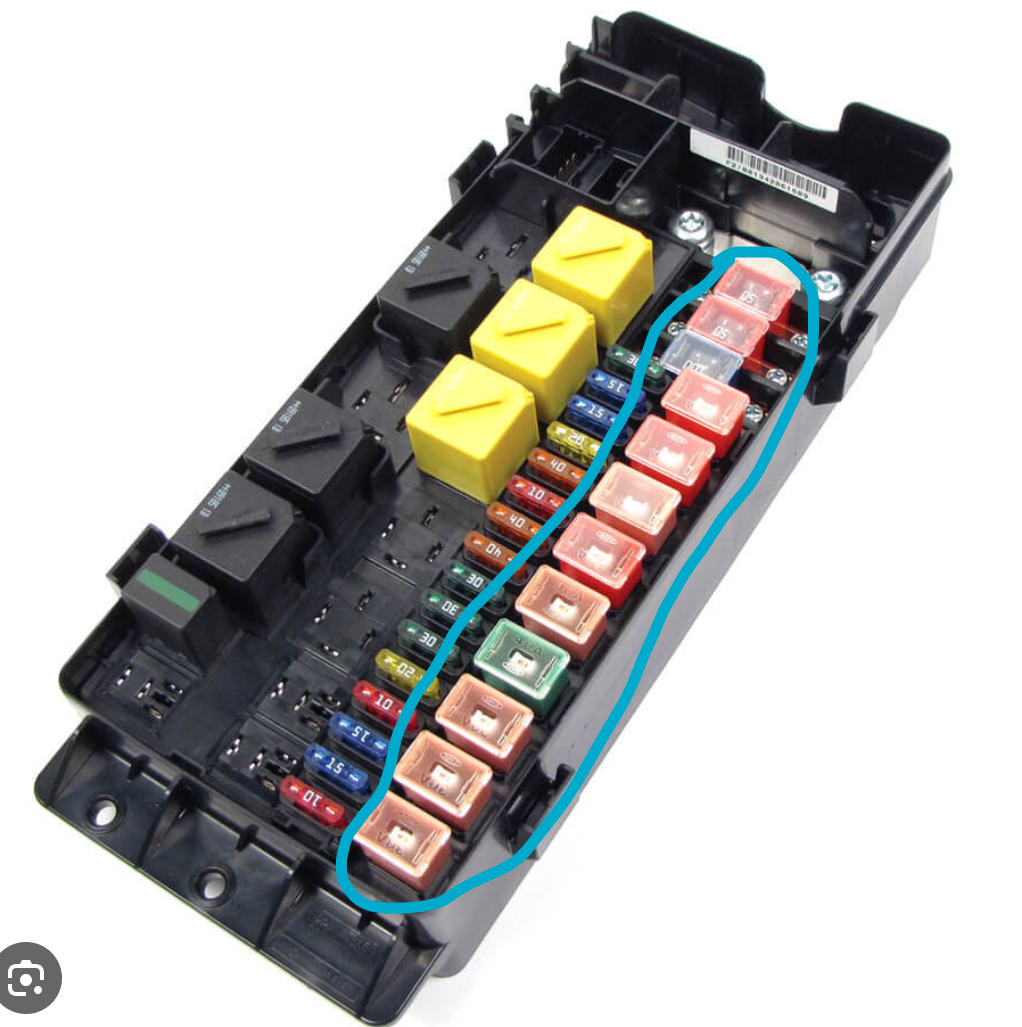

Check the fusible links in the engine compartment too. You might need a multi meter for them. Also double check that all the fuses are the correct amperage. If some are not, its possible something else became a "fuse" and burned.

Fusible links? Are they in the fuse box or elsewhere? I checked everything in the fusebox and all of them are stock/factory and haven't been altered. I'm planning on double checking all the grounds soon. I had another weird thing where my off-road lights were flashing in the middle of the night during a rainstorm. I think water got into the relay or the ground became loose. That was 2 weeks ago though, and after taking out the relay and putting it back its been fine.

These are the fusible links in the engine bay fusebox. I forgot they were clear on the top, so you probably already checked them. If you haven't already, try unplugging the battery, connecting the terminals on the car, and plugging the battery back in. There could by some kind of power trip switch somewhere.

@evil_goat I did check those and they appear to be in good shape!

2) Yes, it could be fusible links -- in the underhood fuse box. But, Then the question is ... why would they blow and that points right back to #1 for me.
