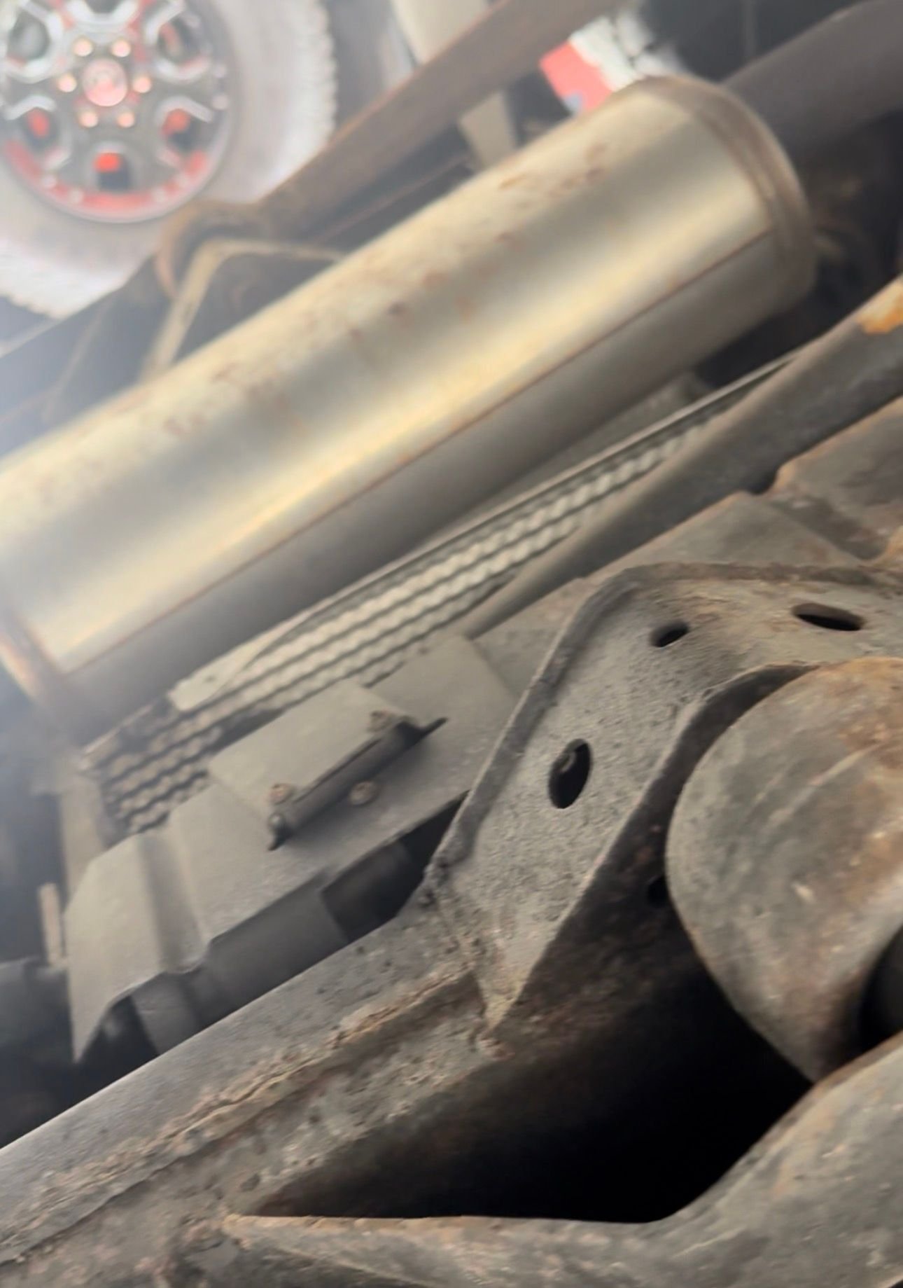

Default Cat converter
If it’s a slipped liner or head gasket, what’s a rough cost for this?
the car has catalytic converter. See pic attached. Where could a gas leak be coming from and is this a
costly repair?

It does sound like it could be a slipped sleeve although it could also just be an exhaust leak. The exhaust leak would be relatively cheap to fix but the slip sleeve is a bit more expensive. Where are you located? Have you already bought this truck?
