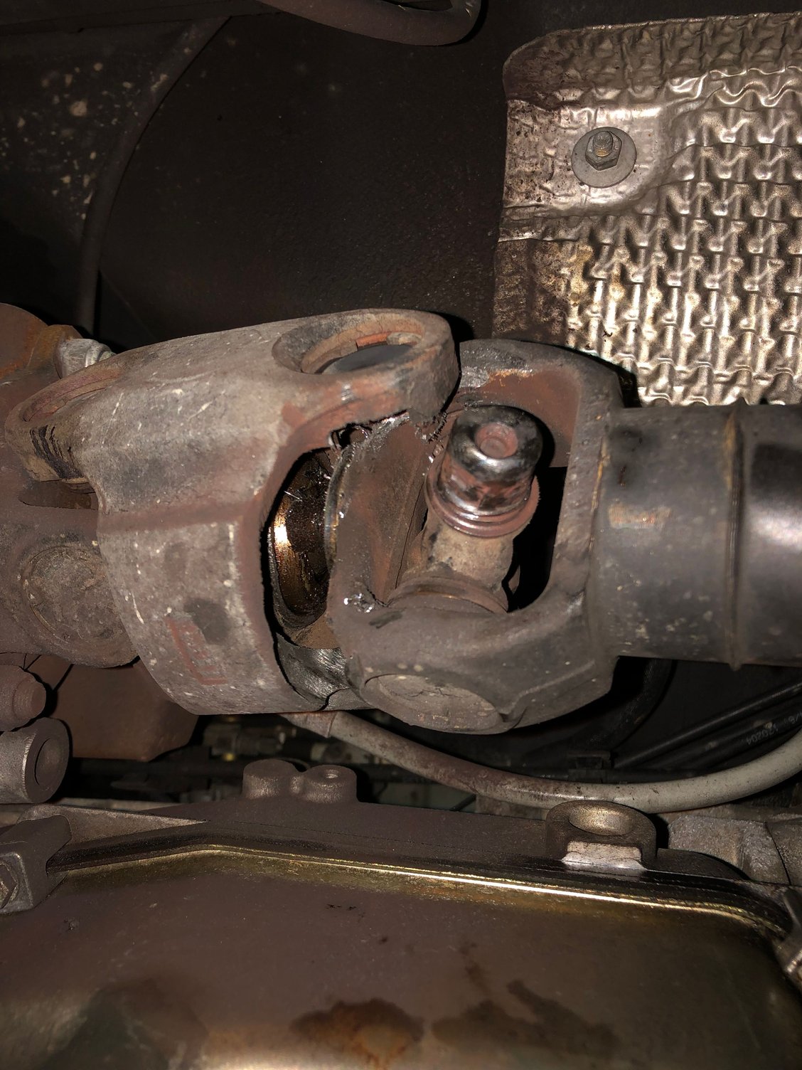

My beautifully shredded U Joint (front driveshaft closest to transfer case). Luckily this happened at approx. 1 MPH and not 60, or I'd be in a lot of trouble.
Old Aug 1, 2019 | 09:32 PM
Looks like there is a chunk missing out of the yoke I would call the guys at www.lucky8llc.com and get a new one coming

Good points I didn't even think about that chunk missing.
