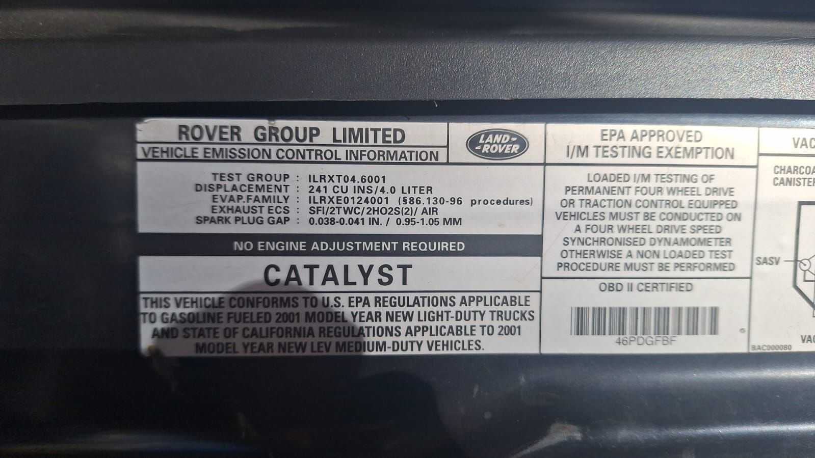

Need help identifying if my motor is 4.0 or 4.6

Yeah, it definitely is an '03/'04 since it has the facelift. Based on your plate, it isn't a north American model. Maybe they had different engine options in other countries so might be 4.0? Does it feel more powerful than the 4.0 disco you drove? If the previous 4.0 had a different intake manifold, the newer 4.0 manifold one made more power. But like I said, the vin decoder should tell you what engine size it has.

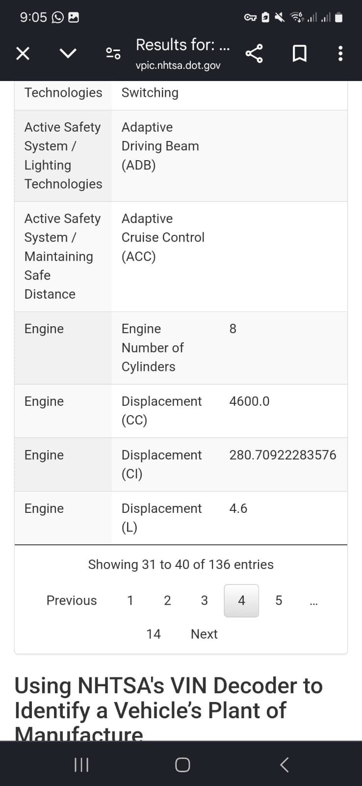

the vin decoder came back as 4.6 engine. But why does the plate upfront say 4.0?

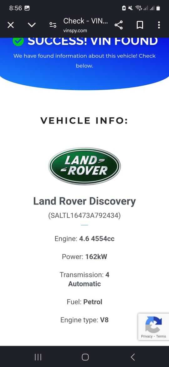

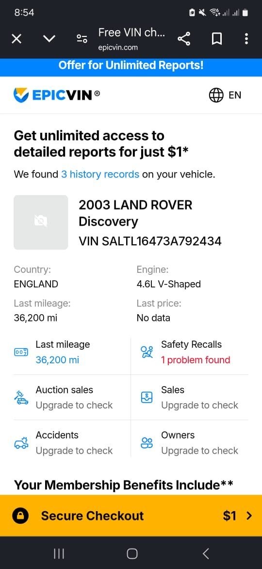

When I put the VIN on epic vin this information came up. Does this mean its an England vehicle hence why it came with 4.0?

That might just mean that it was made in England. However the VIN starts with SALTL164 and all North American models should start with SALTY124 meaning it is probably an English model.

Probably a better chance that the radiator support was replaced due to damage than the engine being incorrect unless it's a non us market oddity.

im trying to figure out if i can identify the engine from the number thats on the block where the end of oil dipstick is? That number is 08d07922h
cr937
when i put the vin and search online, it comes back as 4.6 displacement with country origin england.
but the badge on the fron of vehicle under hood says its a 4.0 displacement. I dont want to buy it unless im positive its a 4.6….
I attached some photos maybe someone has any ideas to make sure without opening the motor to see the crank stamped with 4.6 or 4.0.
