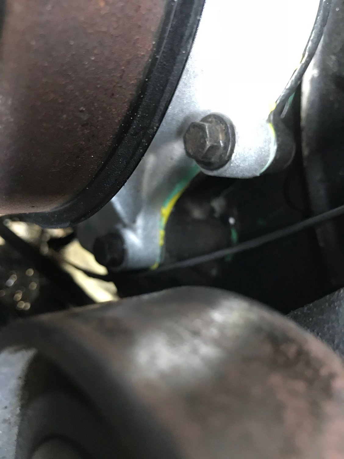

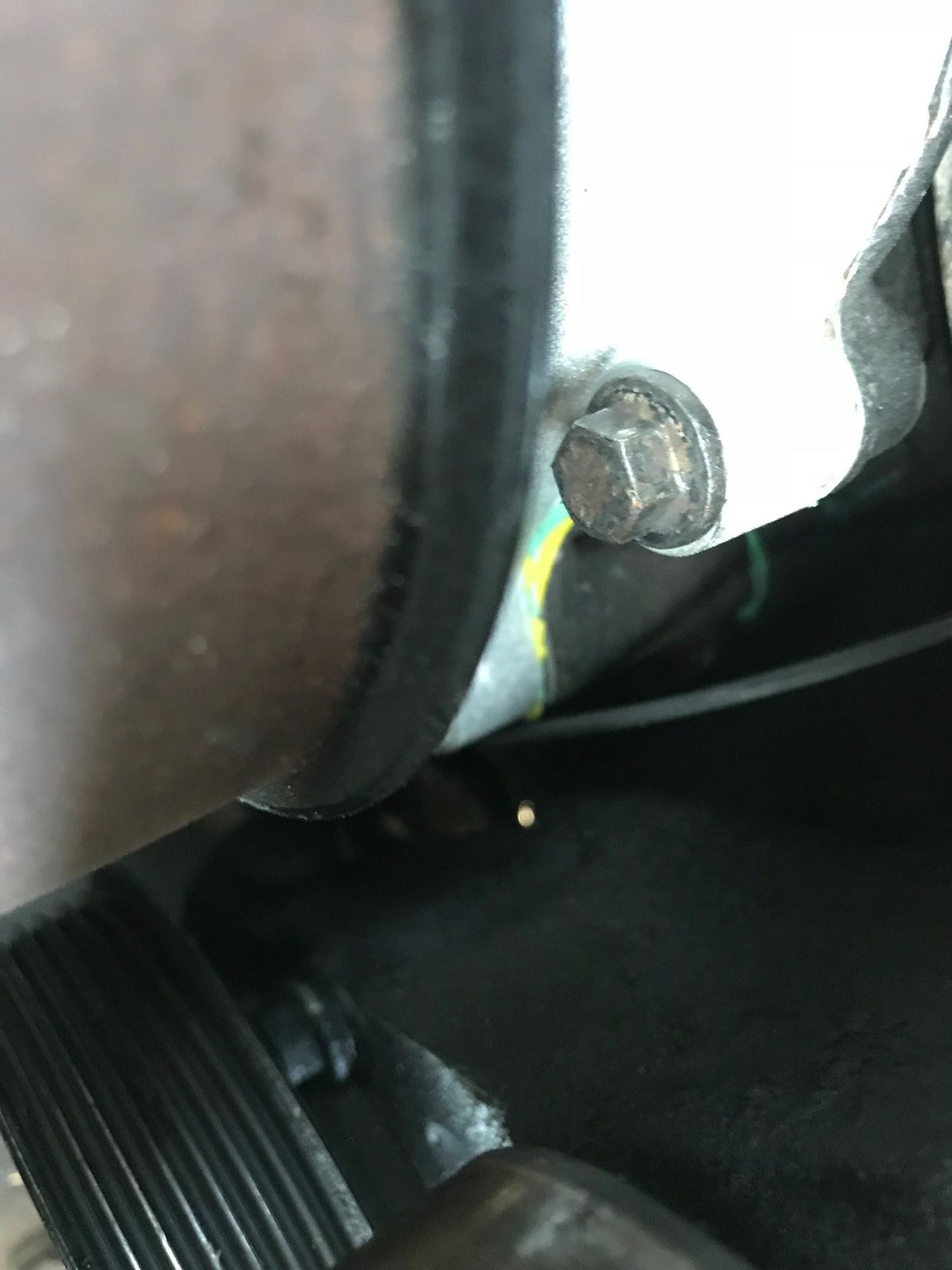

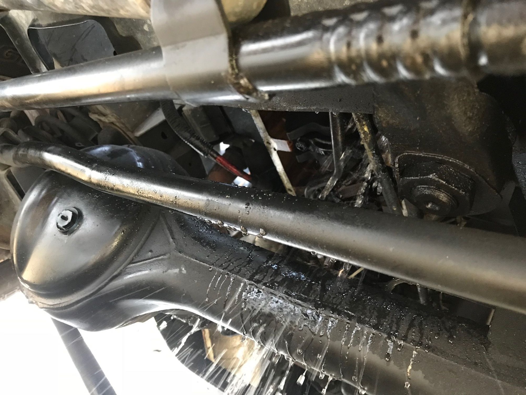

Not the best pictures. I can't get a picture of the stream coming from behind water pump of the side of the engine.
Old Aug 20, 2018 | 04:55 PM
Richard Gallant's Avatar
Joined: Sep 2017
Posts: 3,829
Likes: 1,343
From: Mission BC Canada
That amount of water almost seems like a torn or disconnected hose,the bypass hose kind of goes up there.
Old Aug 20, 2018 | 05:07 PM
duscarter's Avatar
Joined: Aug 2018
Posts: 60
From: Little River, SC
That's what I was thinking too, but I've read so much about blocks and head gaskets. I've taken the alternator off, and almost have the intake off. Those 2 8mm on the coil are tough to get at.
I'll see if I can find a hose now.

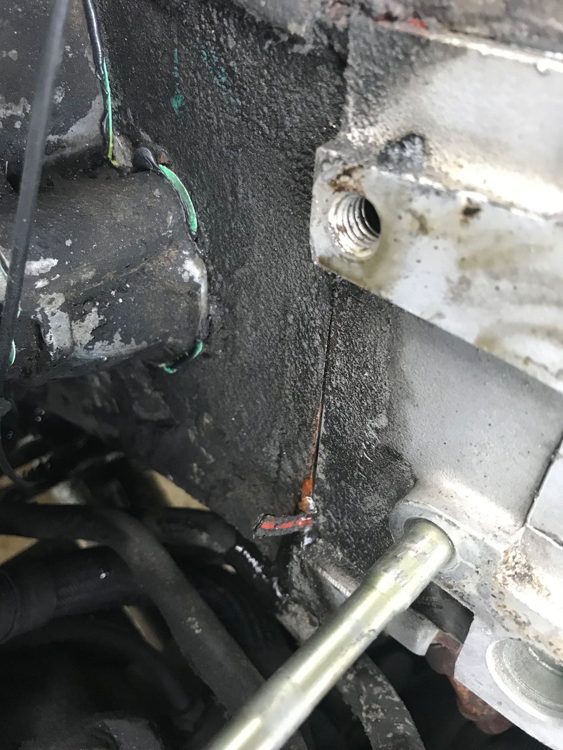

I think we found the problem. Not sure if you can see the water leaking from the head, but you can probably see the piece of gasket sticking out.
Thinking I should tear it down first, to make sure there is no crack in the block before ordering a head gasket kit.
Old Aug 20, 2018 | 07:06 PM
Joined: Sep 2017
Posts: 3,829
Likes: 1,343
Yea that is not looking good. From the picture it looks like a "wedge shaped" opening increasing in width from the top of the frame down ?
Old Aug 20, 2018 | 07:16 PM
duscarter's Avatar
Joined: Aug 2018
Posts: 60
Increasing from top of frame up. I'm wondering how tight the head bolts will be. Might tackle the rest of the tear down when I get off work tomorrow.
