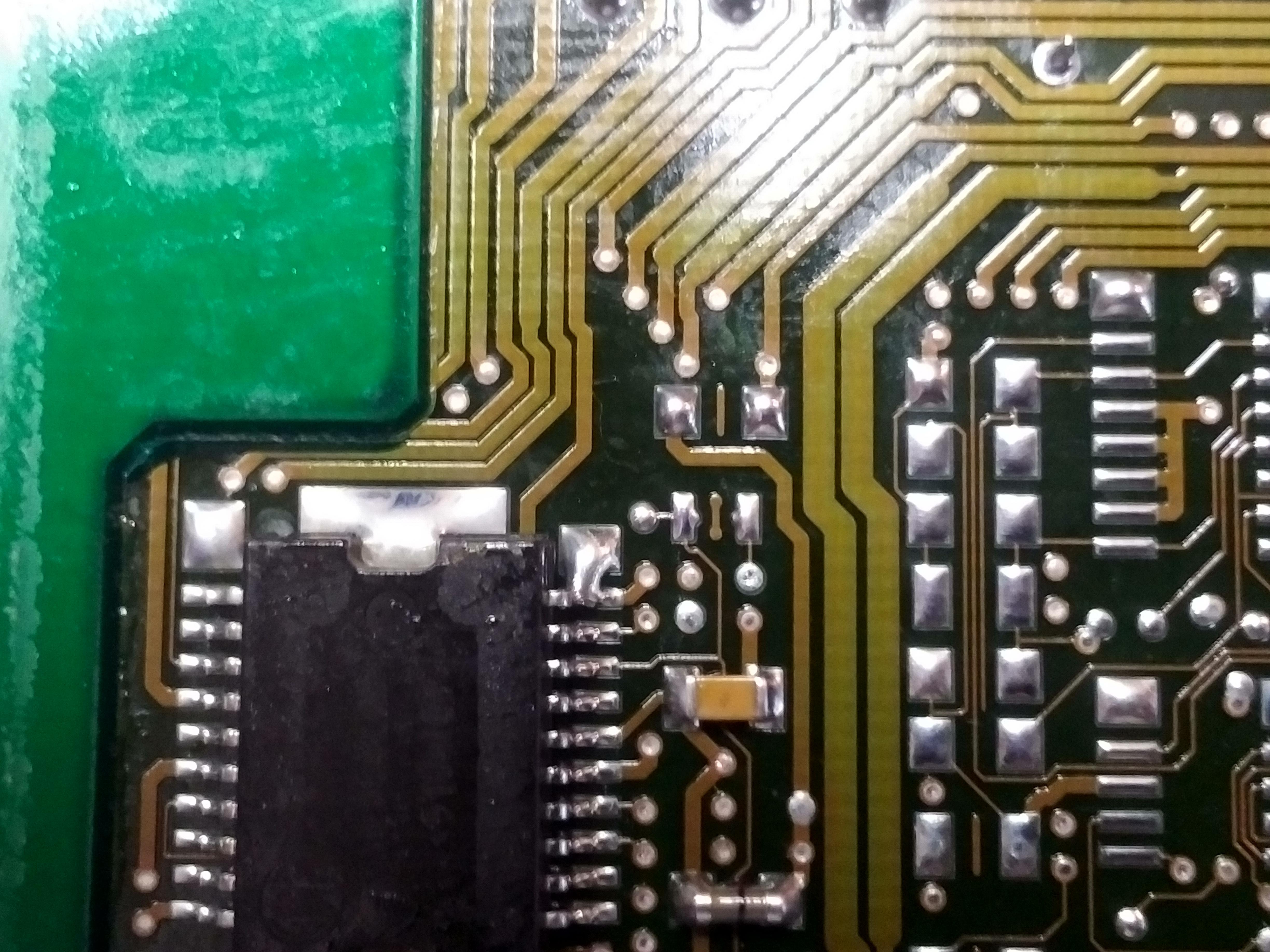

I think I found a problem. I have no idea what circuit this is one but that is clearly a solder run isn't it? I can't find anything else on either side of the board that looks like that.

Okay, I think I see what you're talking about. The solder that looks like it has run into another component on the board?
It's really hard to say if that's correct or not. I work on circuit boards at one of my jobs sometimes. I have seen solder like that before that was supposed to be there. But I can't say if that is the case with this board. If it is solder that has run like that, chances are it got hot enough to burn something up. Are there any fried components on the board? If not, it may be alright.

I couldn't find any other spots on the board that looked like that, there are plenty of little square solder spots like that around all of the micro chips but none of them run onto one of the legs of the chip. I also didnt see any fried components and nothing else on the vehicle is acting crazy so I'm tempted to think that its probably ok. I'm taking it to a friend on tuesday, he has a real nice soldering station and should be able to fix it. fingers crossed.

Doubt that's a solder run looks intentional. You problem more likely to be outside any box.
