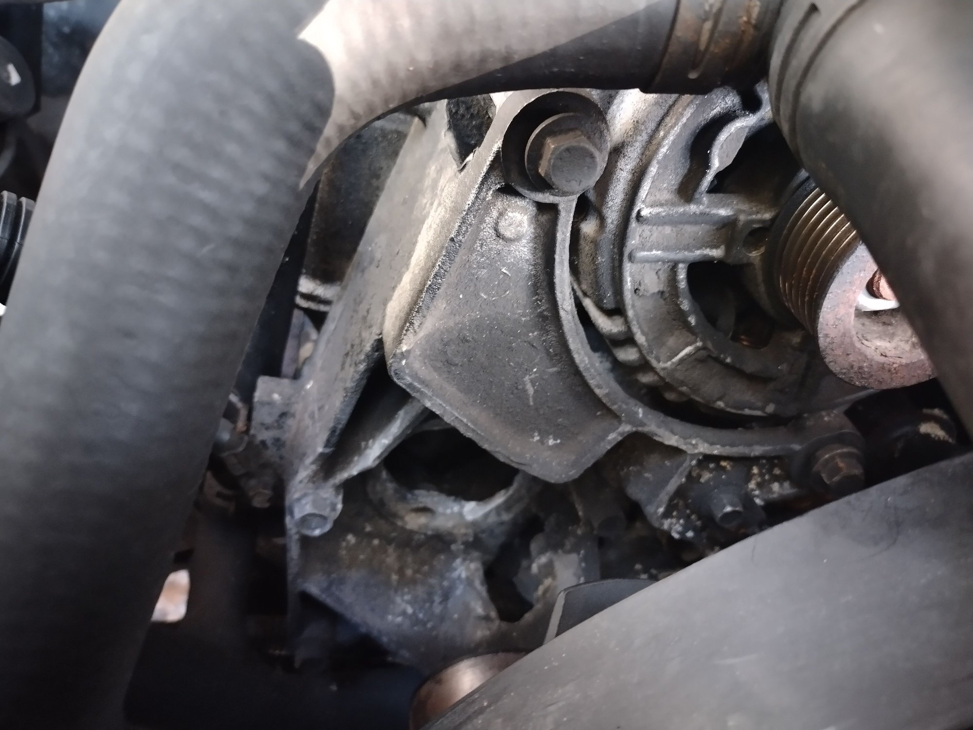

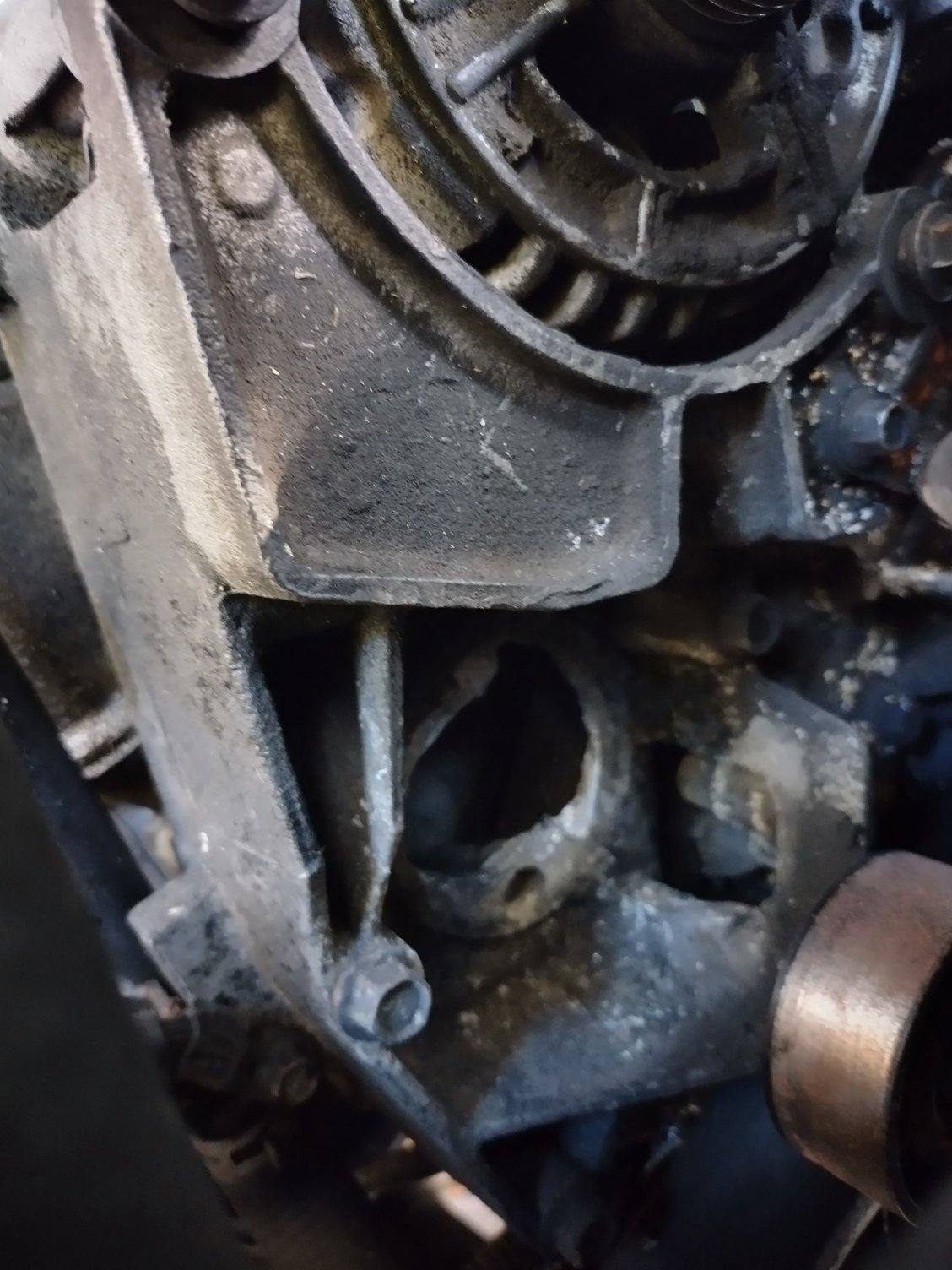

Can anyone please tell me what the housing is called that my tensioner pulley broke off of so I can look for a replaced or my 2001 Rover Discovery II? Land Rover couldn't even help me.

eBay search:
LAND ROVER ALTERNATOR MOUNTING BRACKET DISCO 2 II RANGE P38 99-02 ERR7278 USED

given the corrosion at the failure point, you might want to pick up a belt and tensioner/idler kit as well.......
https://lucky8llc.com/collections/di...lts-tensioners
