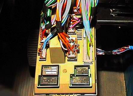

If you review the wiring diagrams in the circuits manual section of the RAVE, you will "discover" that there are two lock motors per door, one for regular, the other for superlock. Locking throws DC volts in one polarity at the motor, unlocking merely reverses that polarity on the same wires to the motor. The schematic will show you points where you can meter that voltage. You could also cut the pink/slate wire that drives the superlock circuit and not have it anymore.
The IDM module and the built in relays are part of the fuse panel. If you replace the panel, may need to leave truck with ignition in position 2 for maybe 5-10 minutes to get BCM to sync with new-to-it IDM. Other than that it is pretty much plug and pray.
Attached Thumbnails New 04 disco owner... cant unlock doors?-d2-fuse-panel.jpg
