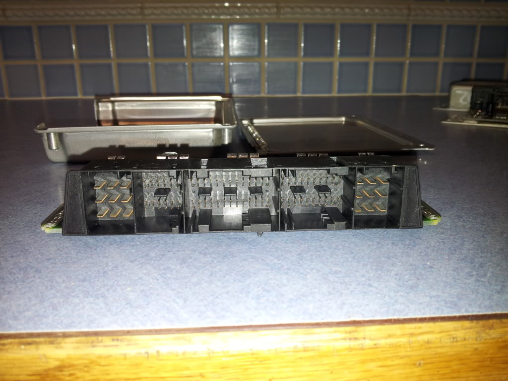

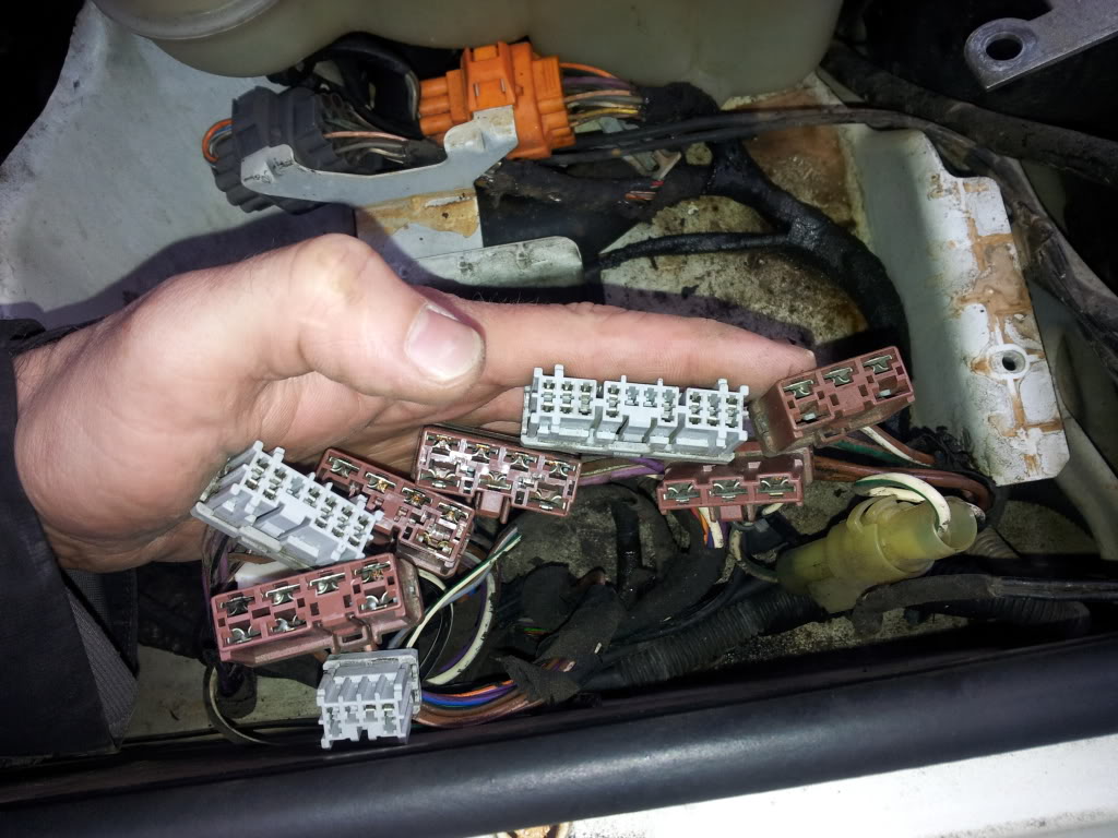

Some pics.
Before

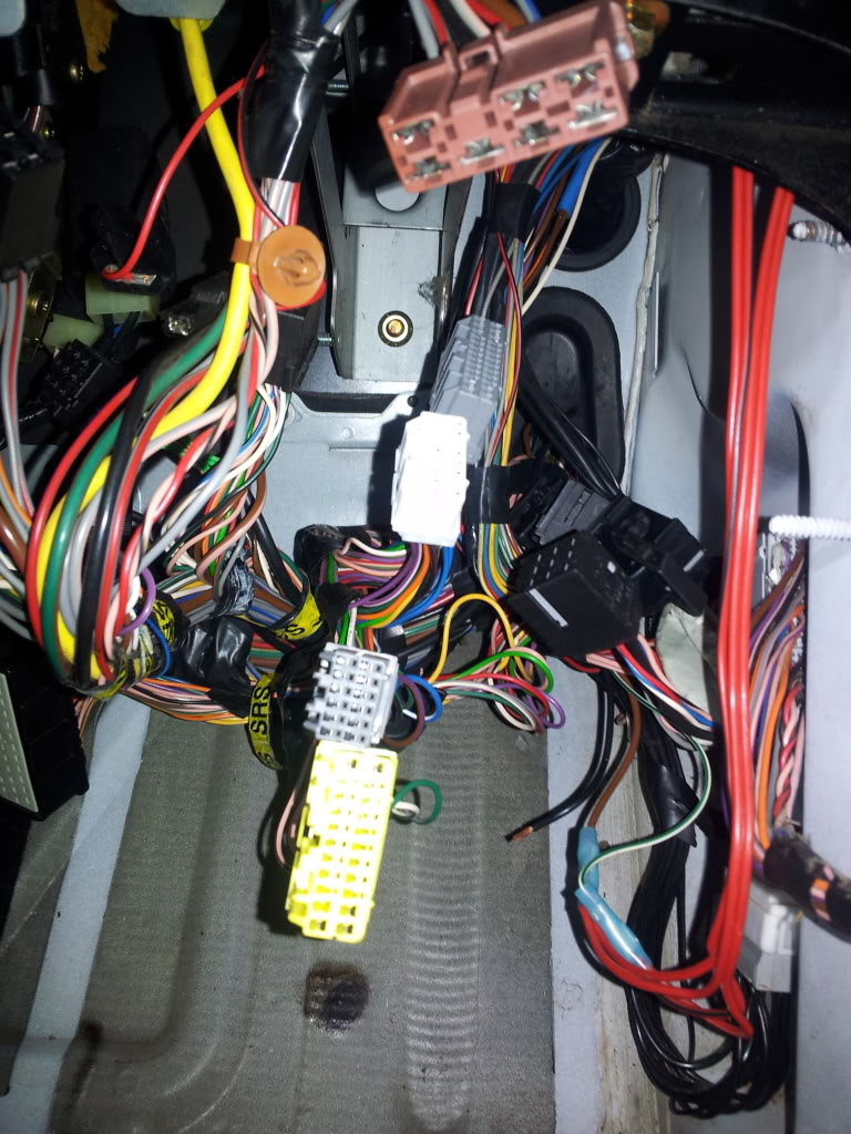

And then some plugs

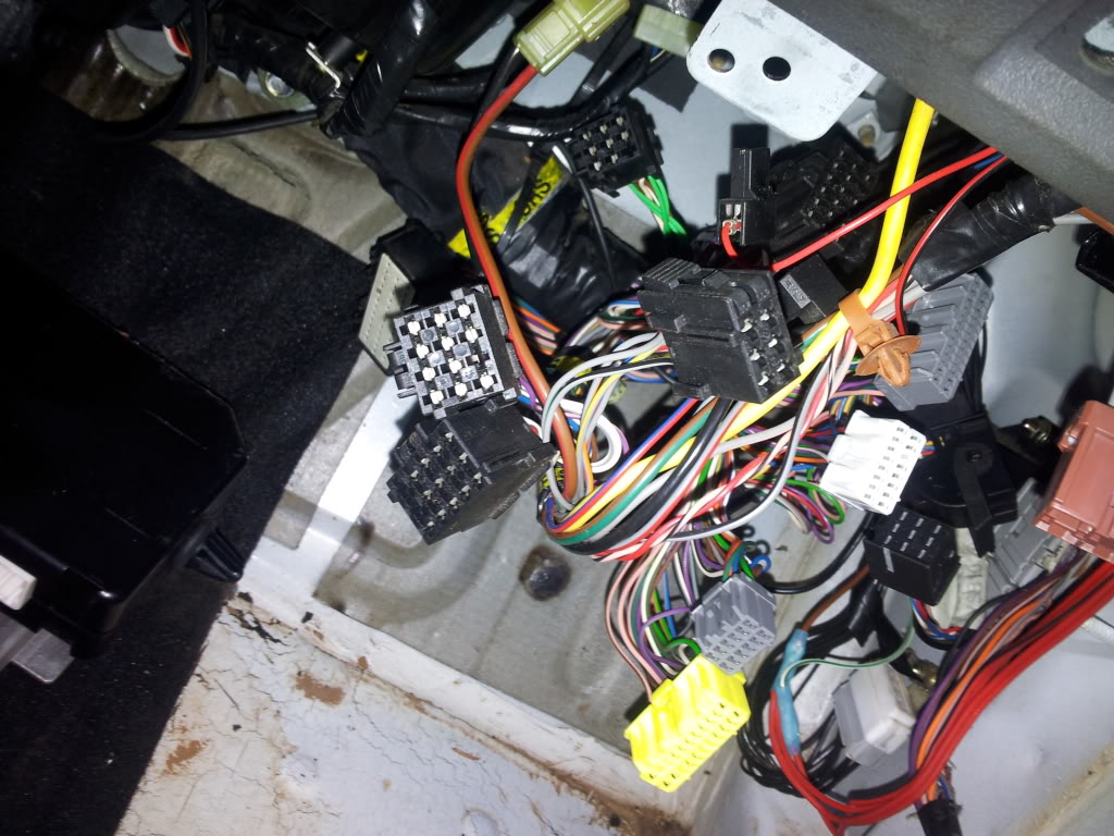

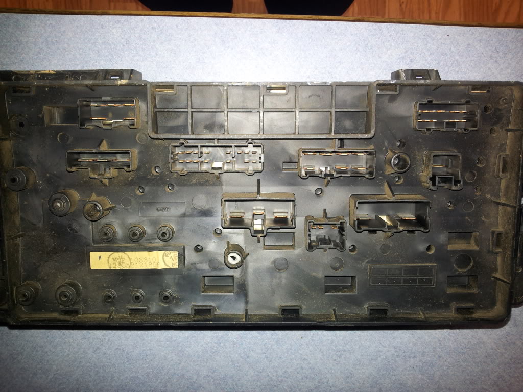

Engine compartment fuse box plugs

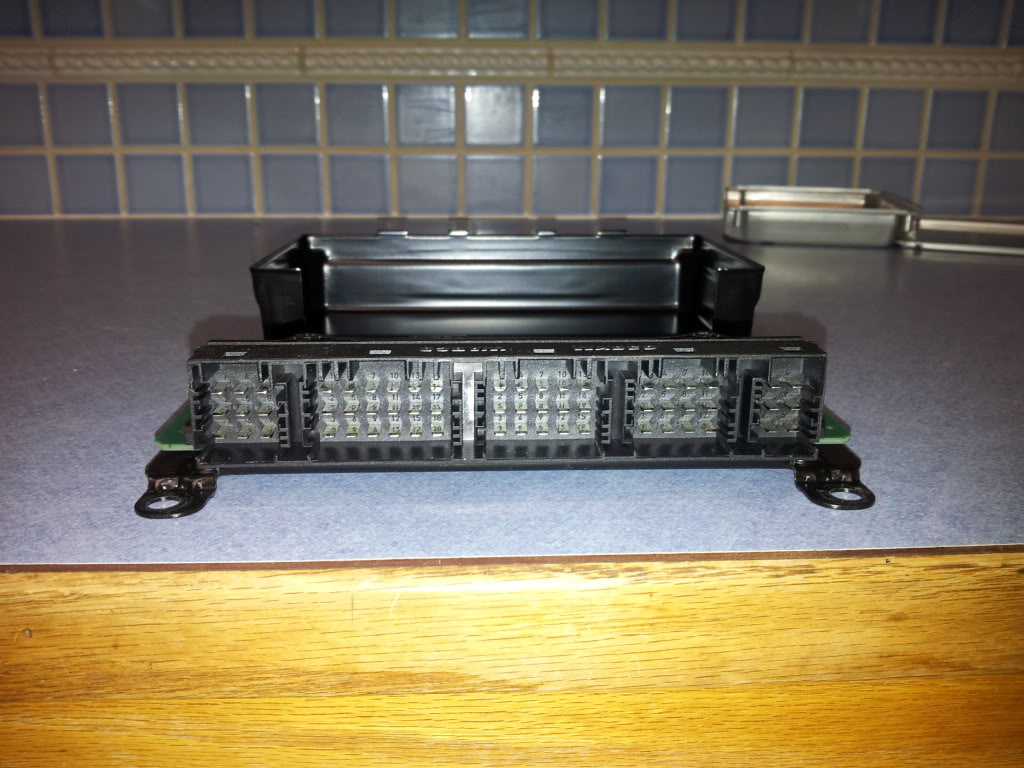

Valeo BCU

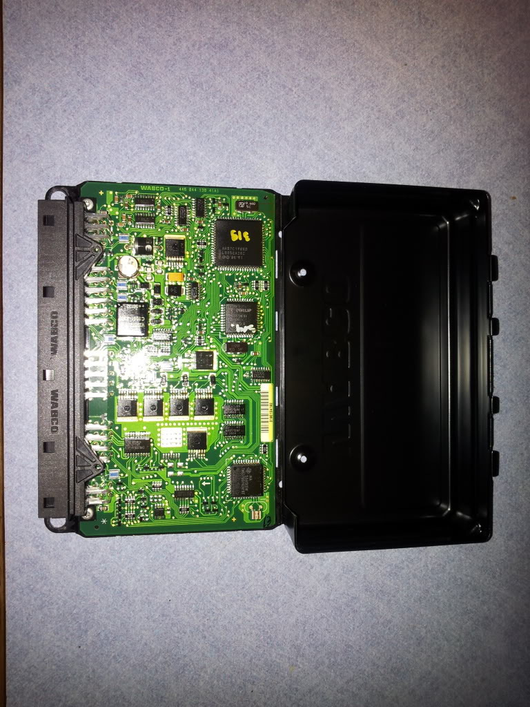

Wabco ABS ECU SLABS

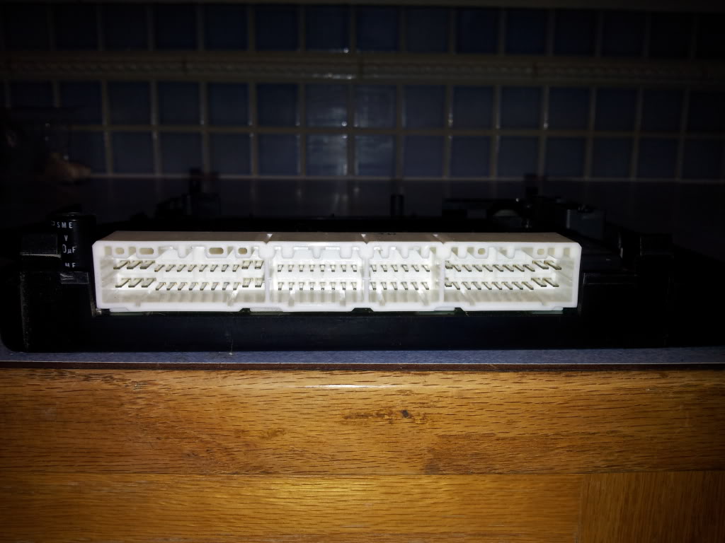

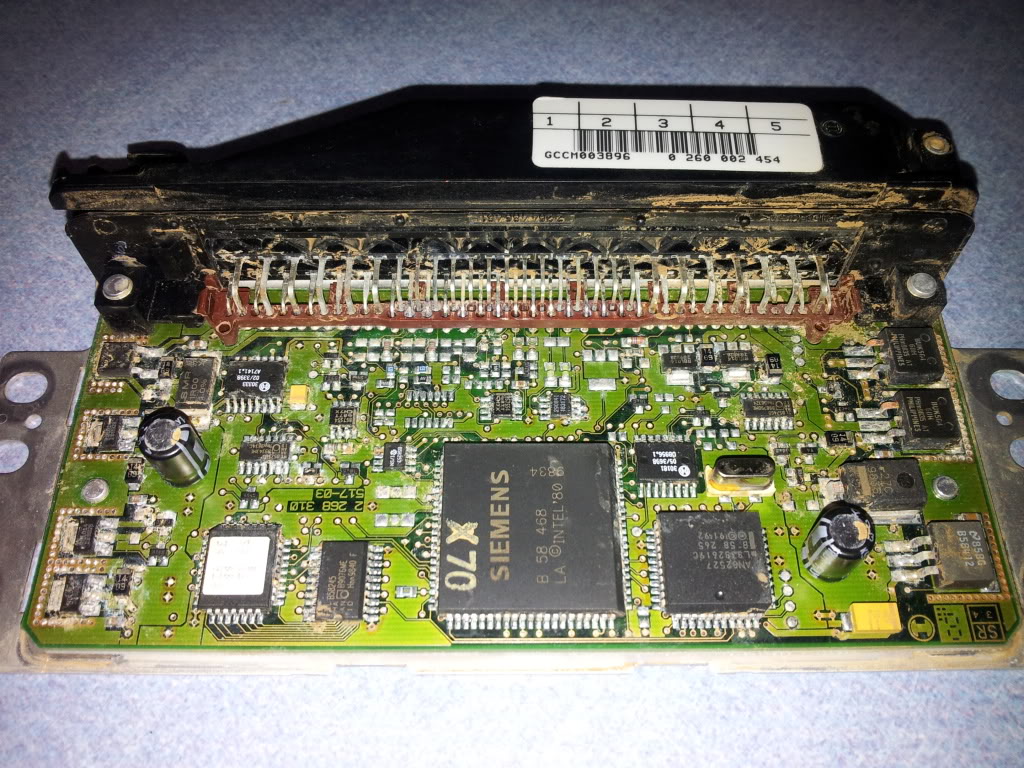

Bosch ECU

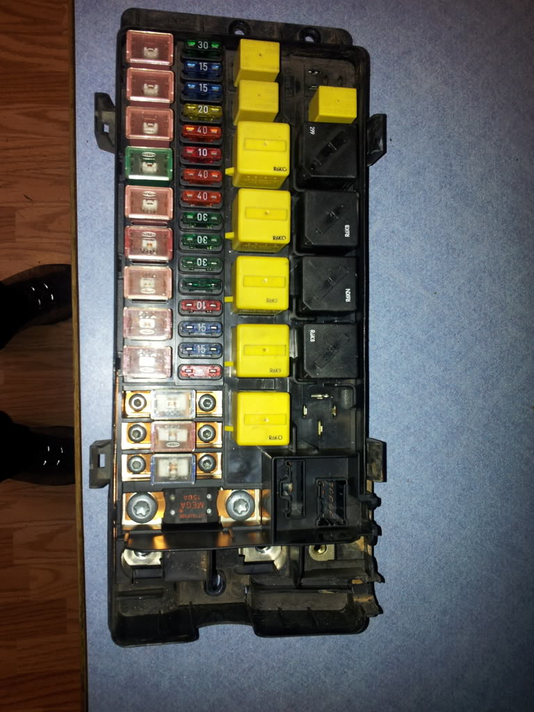

Engine Compartment Fuse Box (the dirtiest but ground was tight and fuses good)

Stuff looks too good to just replace. I want to know the circuit.

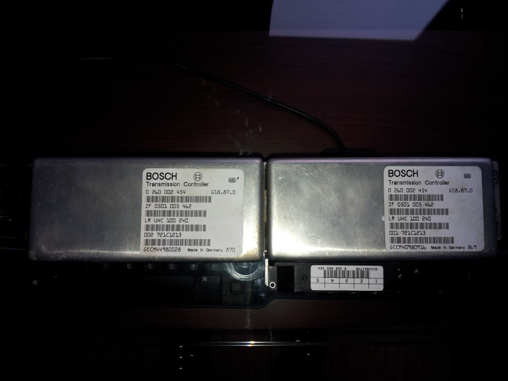

Also the one on the right is the replacement EAT ECU. I didnt feel the need to open it up. It wasn't in the drink. A small discrepancy in the bottom numbers though.

all of the ECU's look good! great sign. you did open up and clean the old tranny ECU right? Or are you saying you didnt open the replacement? Dumb question you checked the connections under the shifter to make sure they were clean and clipped in correctly? Then the next step is to hunt down the ground in the circuit and check the ground from the battery, after that I would check the wiring to make sure there is nothing that is shorting out. DO you have any pics from when you opened up the XYZ?

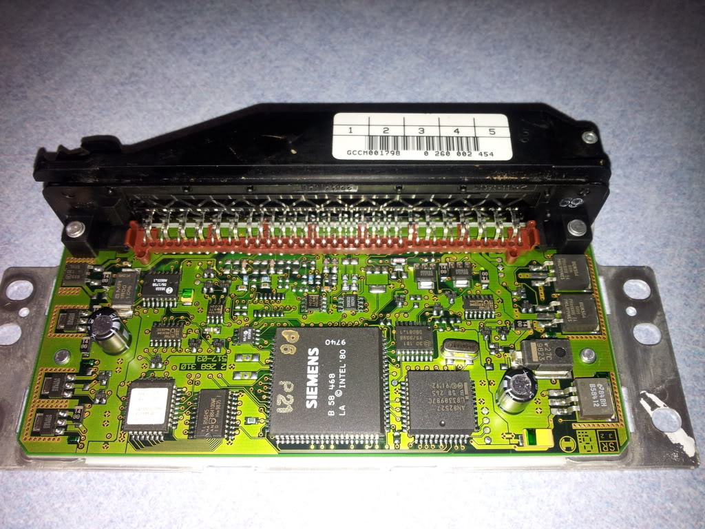

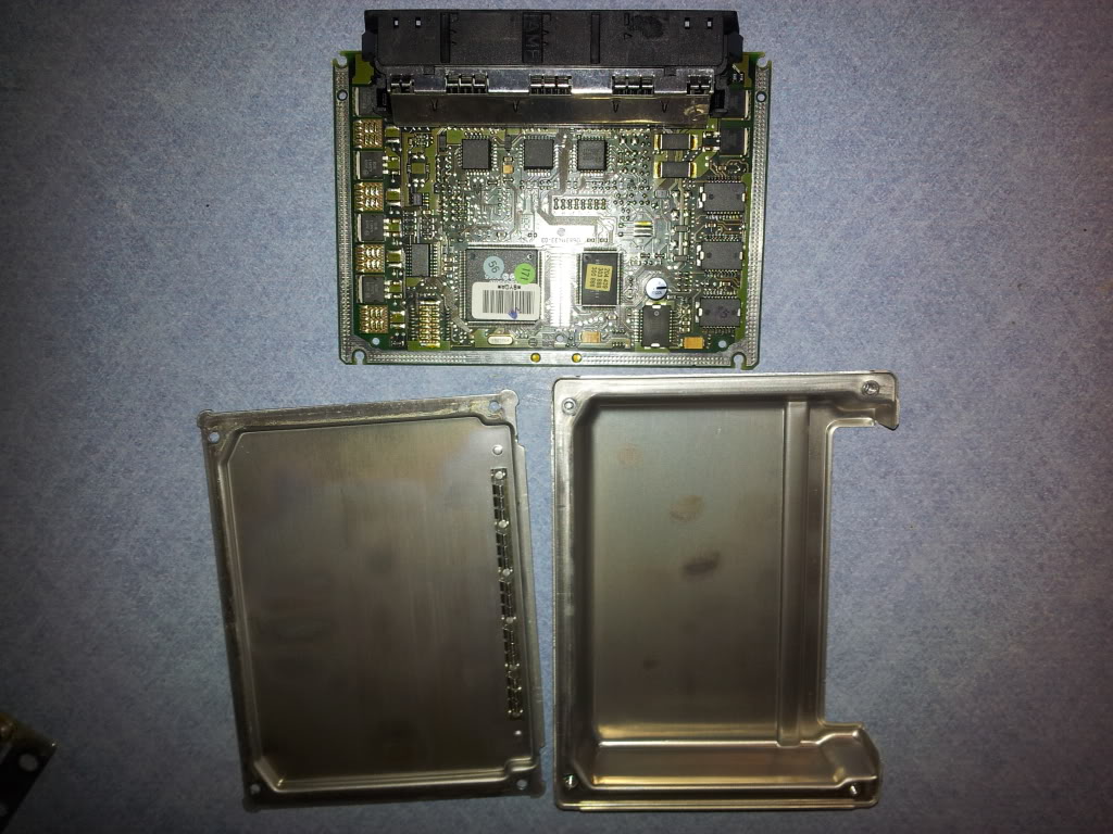

Old one, even after lots of cleaning
New one

Connections under shifter checked and rechecked. Ground from the battery was tight. I will find the circuit. I cant wait to actually start turning a wrench. I have the whole entire line up to go.

your old TCU is not nearly clean enough to work properly. you pulled those black clips off the xyz and cleaned the switches out correct? everything else is good enough for my taste. the scary thing here is your are not getting any gear reading with the old or new TCU. are you in limp mode? the tranny should go into limp with the M and S lights blinking even if the TCU poops the bucket. you are getting codes on the CAN so we know the ECU is working. When you push the shift cable all the way in it should slide into park, and when you pull it can you feel it going through the gears?
