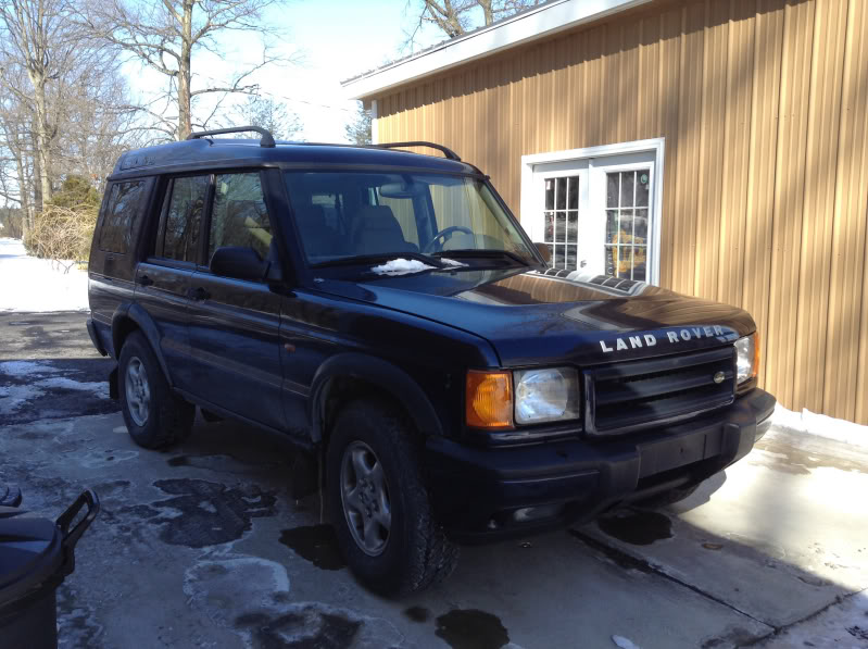

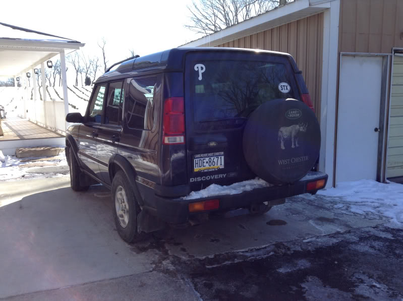

I't does have a few issues. 3 amigos, cruise does not work, yesterday morning the rear drivers side was hanging low and now this morning the whole rear is dragging. It pumps up after starting but the SLS is obviously leaking.

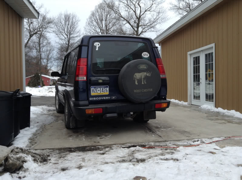

Here is what it looked like this morning after sitting overnight.

Thats a nice looking D2. As far as the airbags go though, unless you're in love with them I would swap to coils. I had SLS on my 99 that would leak down over night. I replaced the bags and made sure there were no leaks but 6months later it was leaking down over night again. Swapped to coils and now there's no headache plus I prefer the feel of coils over bags.
Don't get me wrong it is a nice feature if you pull a lot of trailers and stuff, but you said you've got a sequoia for that.

agree with ^ great if you tow. comfortable ride, but not worth the headache, imo.
as for cruise, megaton of folks have issues with it. vacuum leak was my issue. replaced lines and presto. but it could be a couple of other thing as well.

Yeah I read that you can swap out the bags with coils. The bags are nice but I will probably put the coils in and eliminate the problem and worry.
I think I saw if you do swap in coils you have to reprogram something? If so how involved is that?

yep, good idea to get the computer to know you don't have bags. so you do not get a drain on juice. but I have been needing to do that for a few years and have not had an issue yet.

I hope I can put everything off until warmer weather, my garage is not heated. The fogs and cruise don't matter and so far the bags still inflate and hold once started (only deflate after sitting overnight). Would rather wait until it at least goes above freezing. LoL
