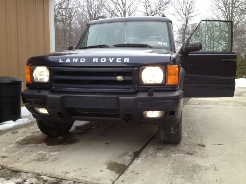

It warmed up to about 38 already today so I looked into the fog lights...... Easy fix! Turned out the fuse was just missing. Couldn't find a 15amp so I put in a 25 just to see and.......
I won't use them until I get to a store and buy some 15 amps.
