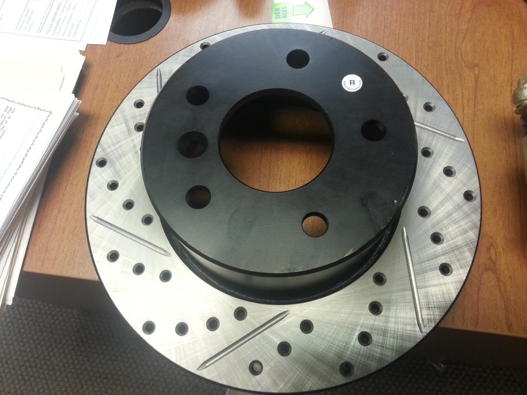

Here are my new rotors from rockauto.com

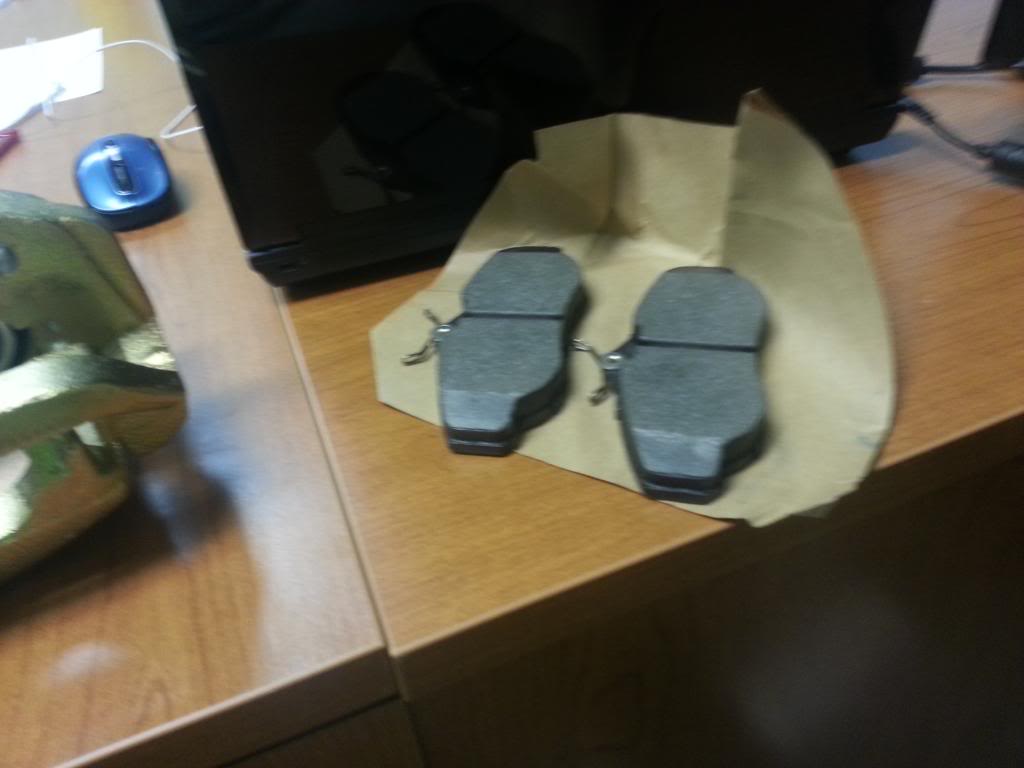

Here are my new Bosch pads from British Parts of Utah

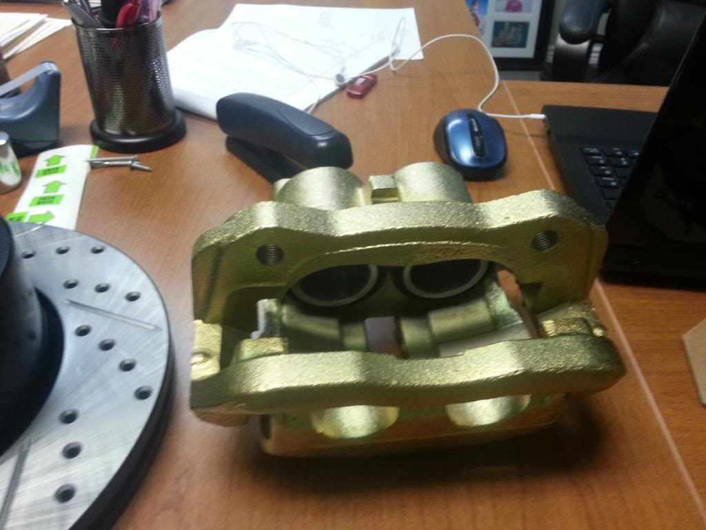

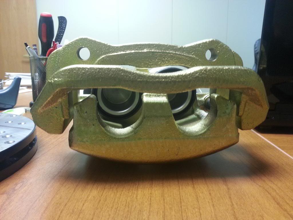

Here are my new calipers - also from bputah.com
I have to admit, I've never done this before. So my question is, am I missing something? Do I have all the needed hardware and parts? Are there any issues I need to be aware of? I can't start pulling parts of my Disco without approval from the forum.

you will need brake fluid when you to bleed the brakes. Also get brake grease to lube the caliper slide pins most like already done since you got new calipers) and lube where the pads contact the caliper
Brake Lubricants: Brake and Front End
Old Sep 5, 2013 | 08:23 PM
br0keit's Avatar
Joined: Apr 2012
Posts: 420
From: Sayreville, NJ
It's pretty easy,
-put on JACK STANDS (please don't die)
-Wheel off (dur, keep wheel around, makes a great seat)
-clamp the brake hoses (either get the right tool or use some needle nose vice grips with some fuel line over the ends to keep the teeth from chewing up the rubber)
-old caliper off (oyur new calipers should have come with carriers so no need to separate, just take the 2 caliper bolts off and you're set save the banjo bolt washers if you didnt get new ones with your new calipers)
-rotor off (a dead blow hammer and an impact driver for that damned screw might be useful here)
-new rotor on (I smear anti-seize all over the hub and hub ring.
-new caliper on (dont forget the banjo bolt washers! and i'd threadlock the bolts, I had one fall out on me after doing calipers with no loctite)
-unbolt one of the guide bolts and put in new pads (grease ALL points where the pads touch anything, new calipers should have grease but if you want add more SILICON GREASE, do not use other greases they just get baked and dry up and cause the pins to bind)
-repeat for all 4 and bleed brakes (I do the traditional RR, LR, RF, LF bleed but the rave says something else, bleed until clean fluid with fresh brand new DOT4 fluid, shouldn't take more than a quart)
-wheels back on
-TEST BEFORE TAKING ON ROAD (did I really have to mention this one?)

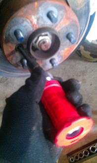

Impact driver from Harbor freight is reasonable and really helps in some cases.
