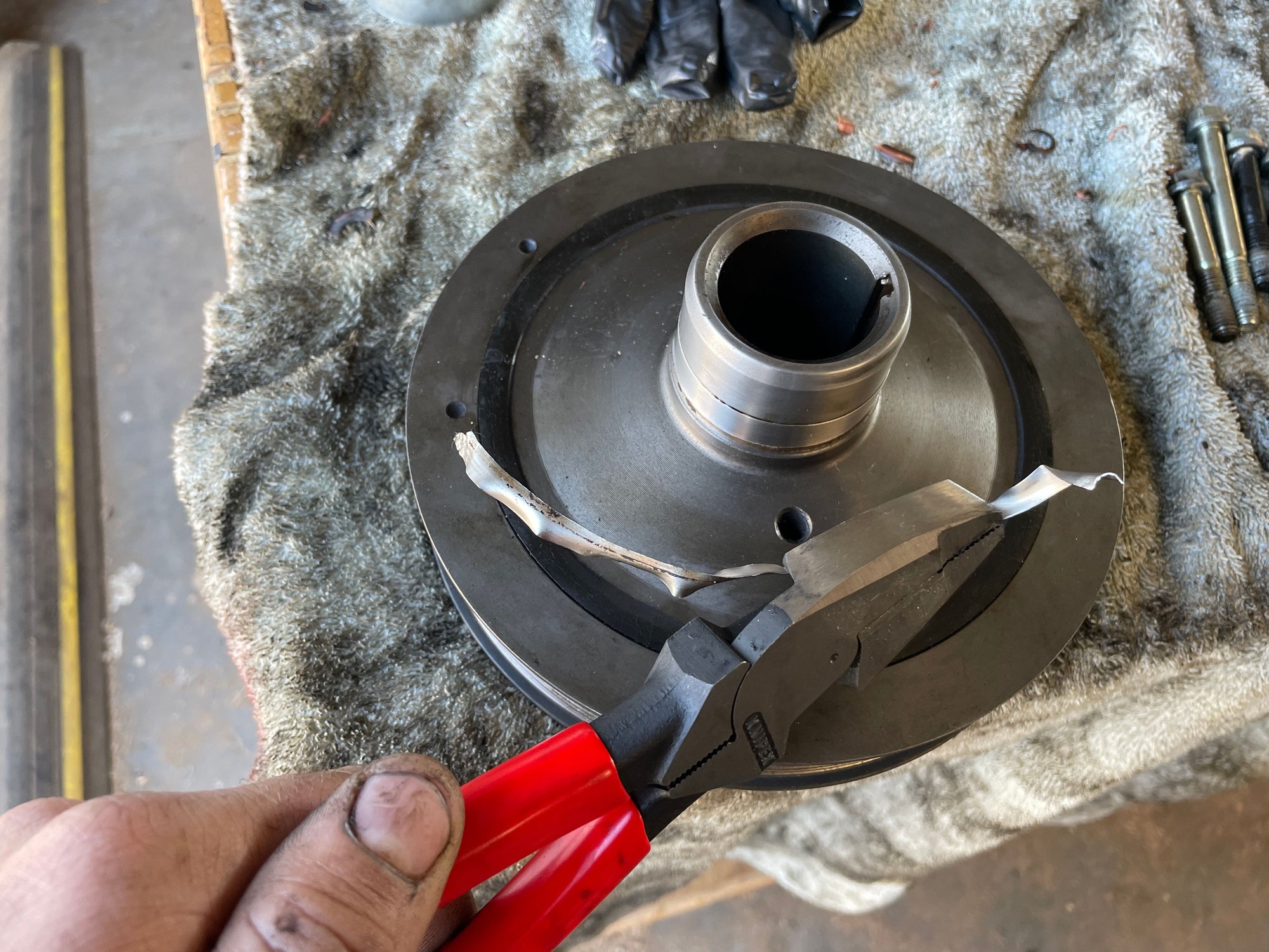

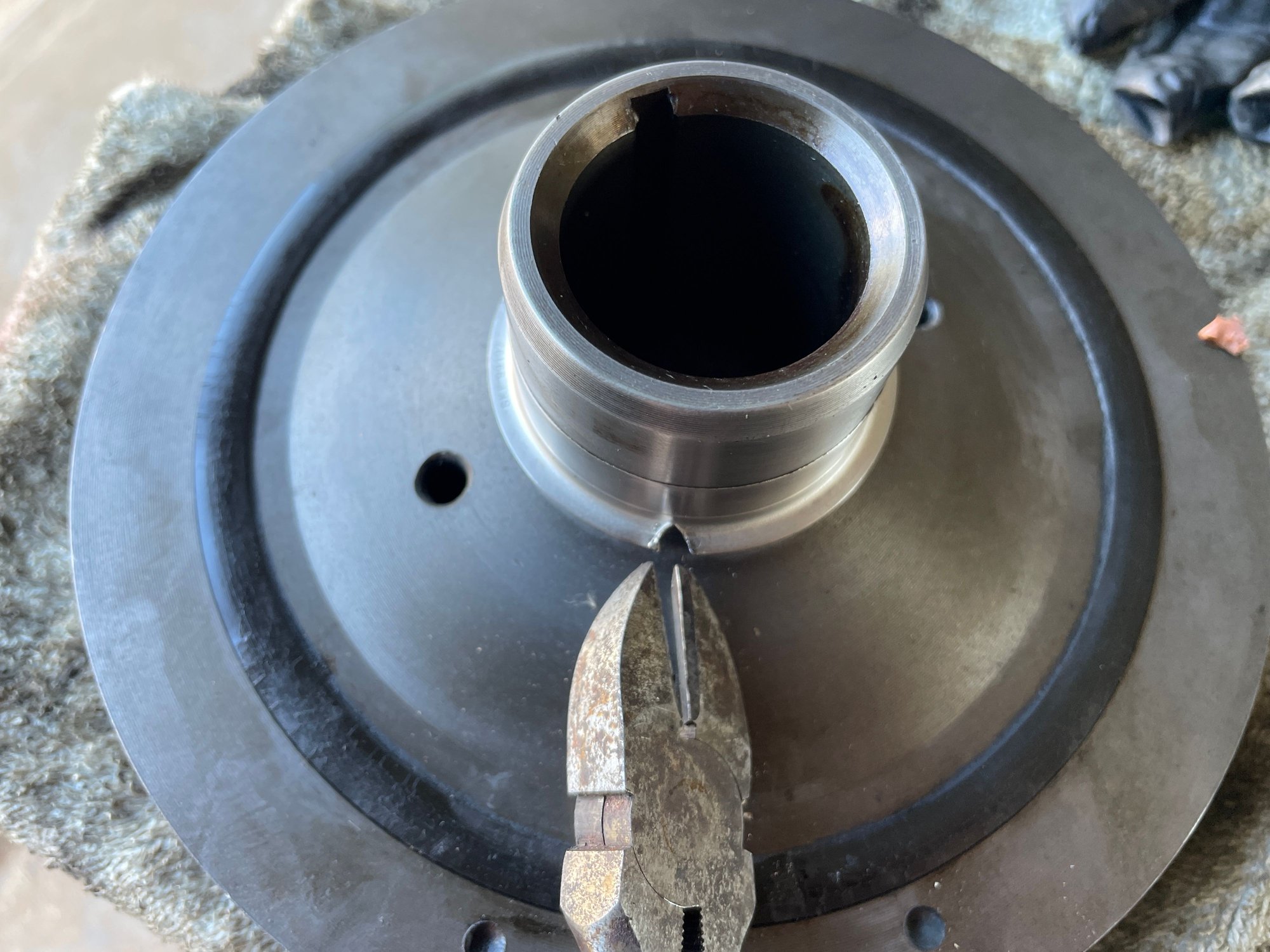

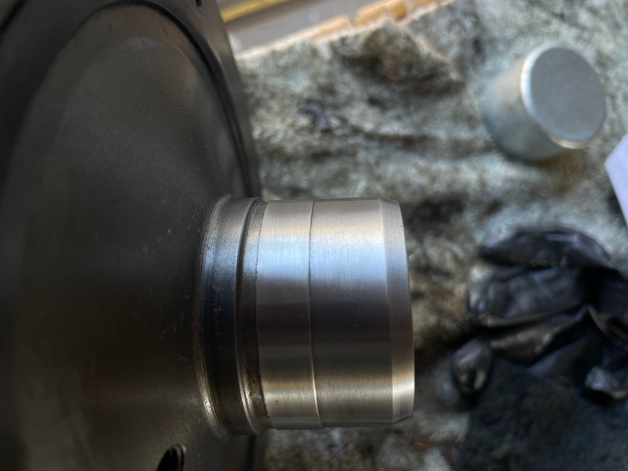

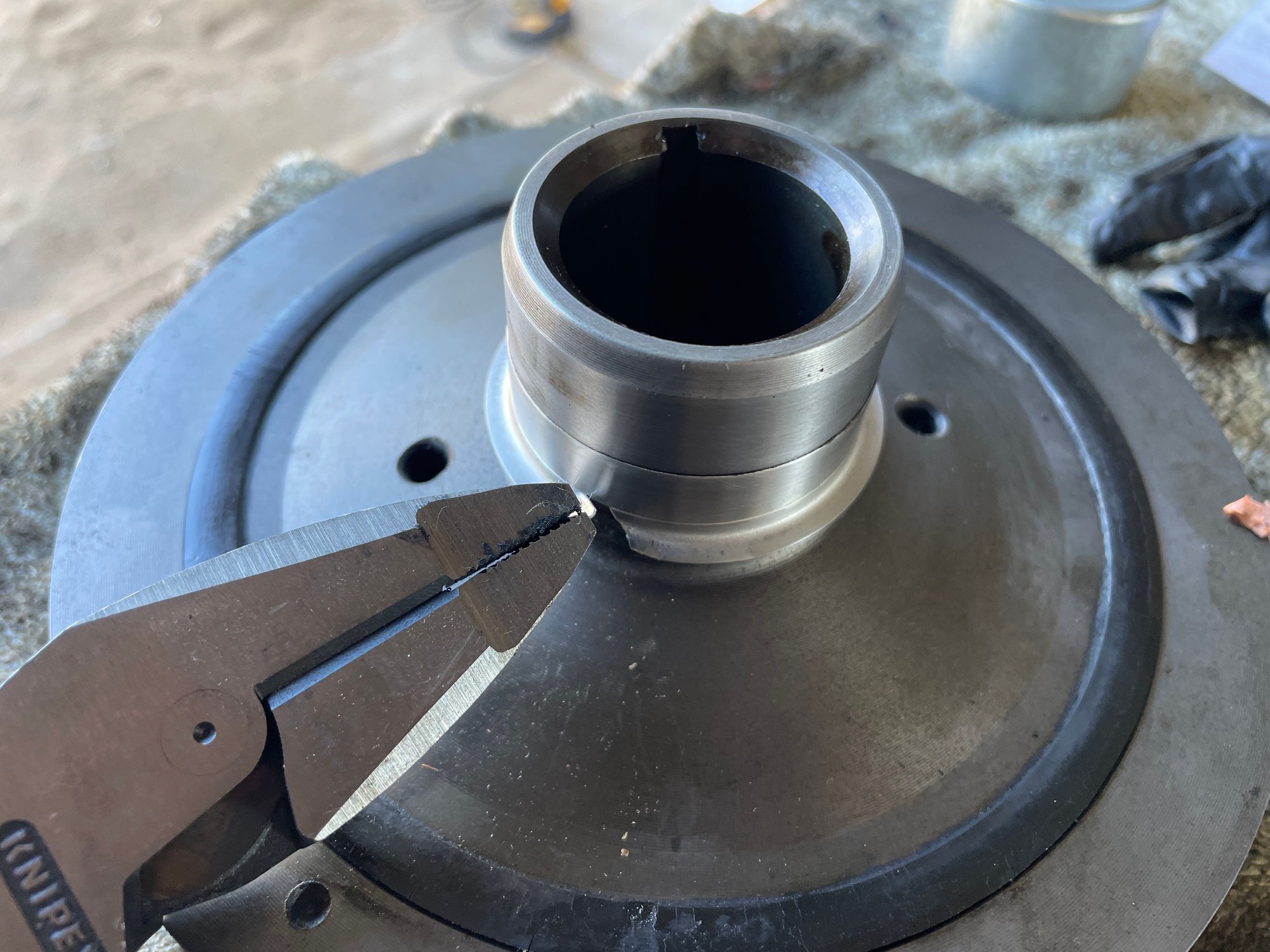

Old Jan 29, 2022 | 07:59 PM
JohnZo's Avatar
Joined: Apr 2021
Posts: 1,416
Likes: 397
From: SE Washington State
Looks like you already have a speedy sleeve on it.

Old Jan 30, 2022 | 09:50 AM
Westminster02's Avatar
Joined: Dec 2021
Posts: 24
Likes: 16
My front crank seal leakage was greatly reduced after I replaced the crank bearings.
Not my pic…from another reply. 👍🏻

Old Jan 30, 2022 | 11:34 AM
Brandon318's Avatar
Joined: Apr 2019
Posts: 2,046
Likes: 608
From: Monterey, CA
Originally Posted by Westminster02
I’ve seen that recommended a couple of times now.
Is install…
- remove crank pulley
- remove front main seal
- clean crank
- install Speedi Sleeve with flange toward block and push on far enough so flange is deep enough for new seal to seat fully in.
- silicone sealant around seal OD (Extinct’s suggestion)
- install new seal
- replace crank pulley & torque to spec
Sound right?
only want to do this one more time. Ha!
Almost. The flange on the speedi sleeve goes toward the pulley, not the block. Then you peel the flange off using snips.
