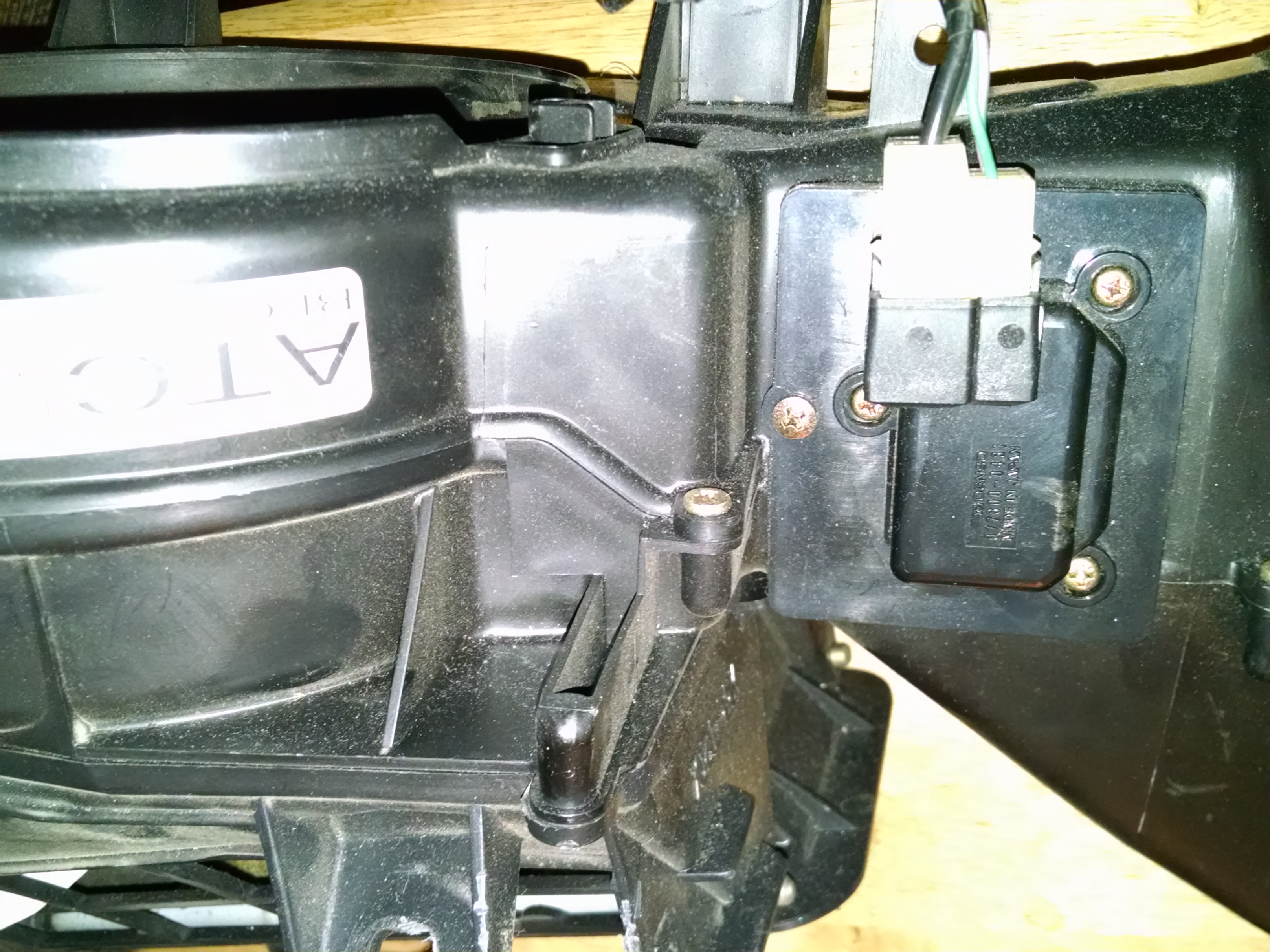

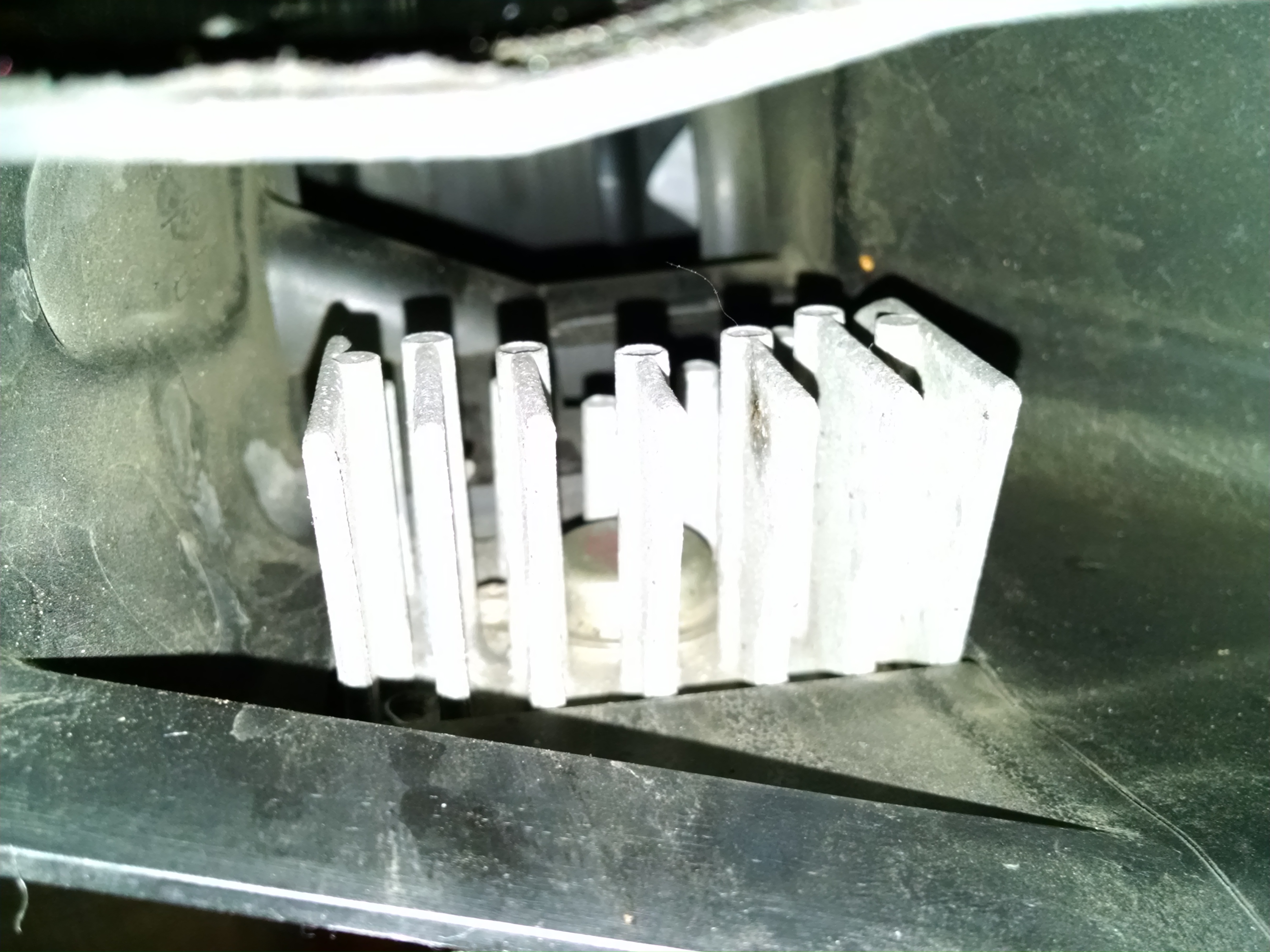

here is a pic of the resister from the out side and inside

As far as the resistor has anyone ever tired to do the resisitor change by unsoldering it and replacing only the resistor? Is there a writeup anywhere about this?
