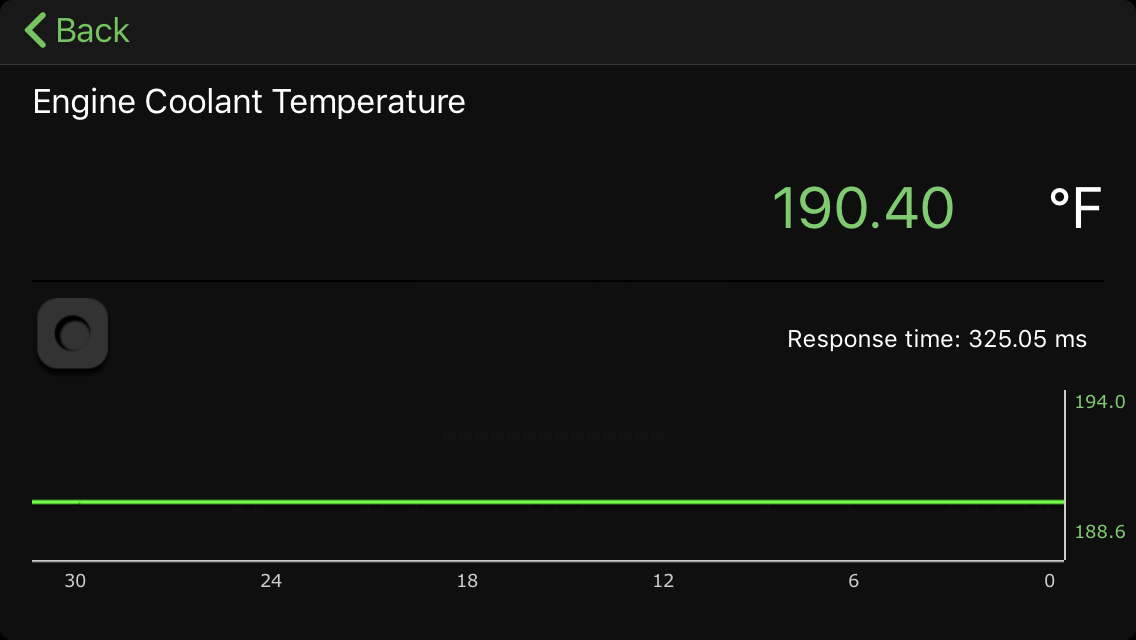

Radiator was a no-name from ebay ~100bucks. Temperatures are 188 consistent while driving, 185 freeway, idle 190-194 consistently.

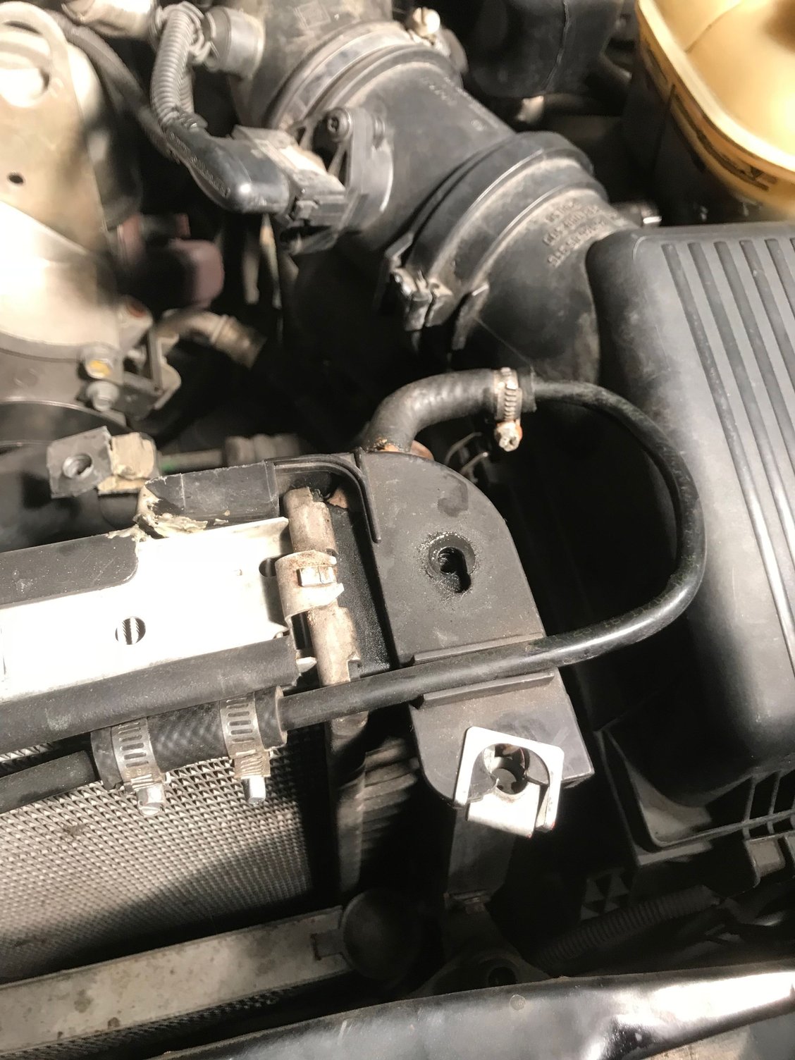

Nasty jb weld on the entry point to radiator, hose crack fix in between

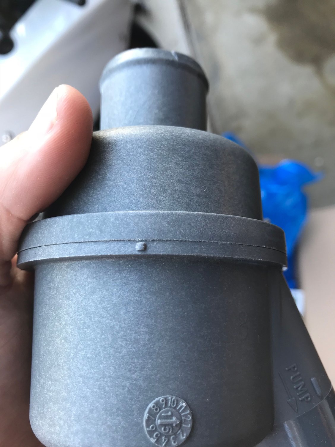

new 180deg t-stat

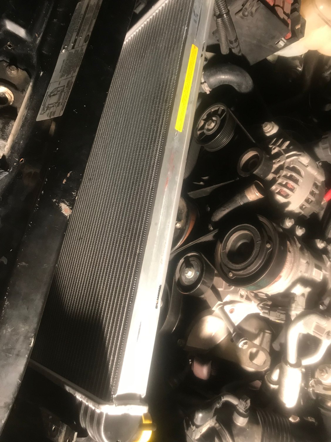

Radiator removed

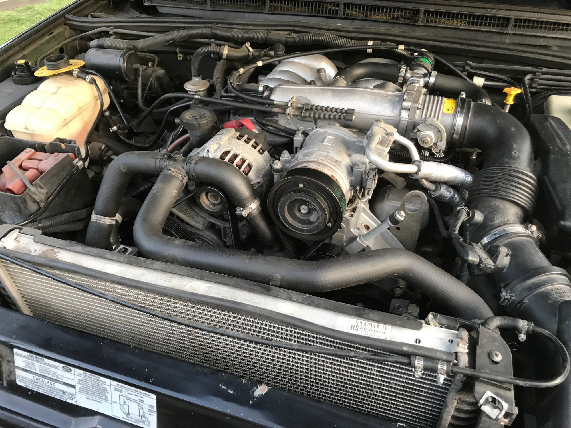

After, installed

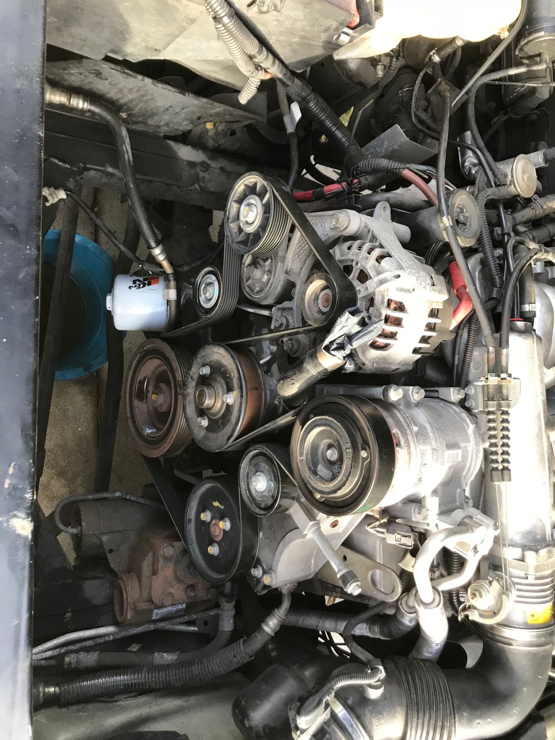

Looks good.
You might want to be sure and wash all the coolant off the belt with clean water, or you next post will be........
...."What is that squeak sound?"

Ha, I figured it would just fly off... But maybe I should. Or just buy a new belt at this point since I just got the truck.

Yes, smart to get a new belt.
Go for a GATES K070922 (w A/C, No ACE) or a GATES K071065 (w AC and ACE).
You can get a good price at RockAuto or these can be had at any NAPA. Go with a GATES Belt and you will be glad you did!

Gates & Dayco (not the value line stuff) have been excellent. Only those 15.00 wonders = I wouldn’t trust for more than a trail repair.

Hope you reinstalled the fan shroud. I didn't see it pictured, but you definitely need it if nothing more than just to hold the hoses out of the fan.
Otherwise, looks great!
Yeah I definitely did

What was the ambient temp with that 190 temp?
Probably 75F outside, it is in San Diego.

Those exactly the temps I have since swapping my thermostat no matter what the outside temp say 20 C down -8 C in BC. My Disco is very consistent, and that is really what is most critical.
I do need to to replace the fan and clutch - but I don't expect big changes.
