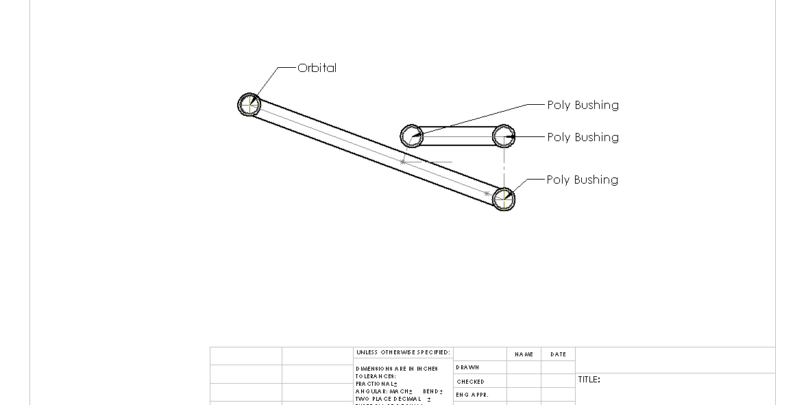

dane, just saw the pic you put up. missed it before.
that be what I am thinking... questions
i figure cm 4130 2"x.250 w/1.50 id tube will be the simplest fab material. surely that is strong enough?
upper arm mount, should be adjustable, no? to tune in angle?

this idea also keeps coming to mind...
the axle bracket makes the concept of removing a bolt a little more stable and keeps the arm behind the axle.
superflex and superior make this for lc and patrol......any thoughts?

Originally Posted by dusty1
Thanks, more to confuse me
I'm trying to process this. Is the idea here to have a removable bolt to give you more flex offroad, and put the bolt back in to firm it up for street driving? My concern here would be the thickness of the steel in that bracket so that it wouldn't bend.
