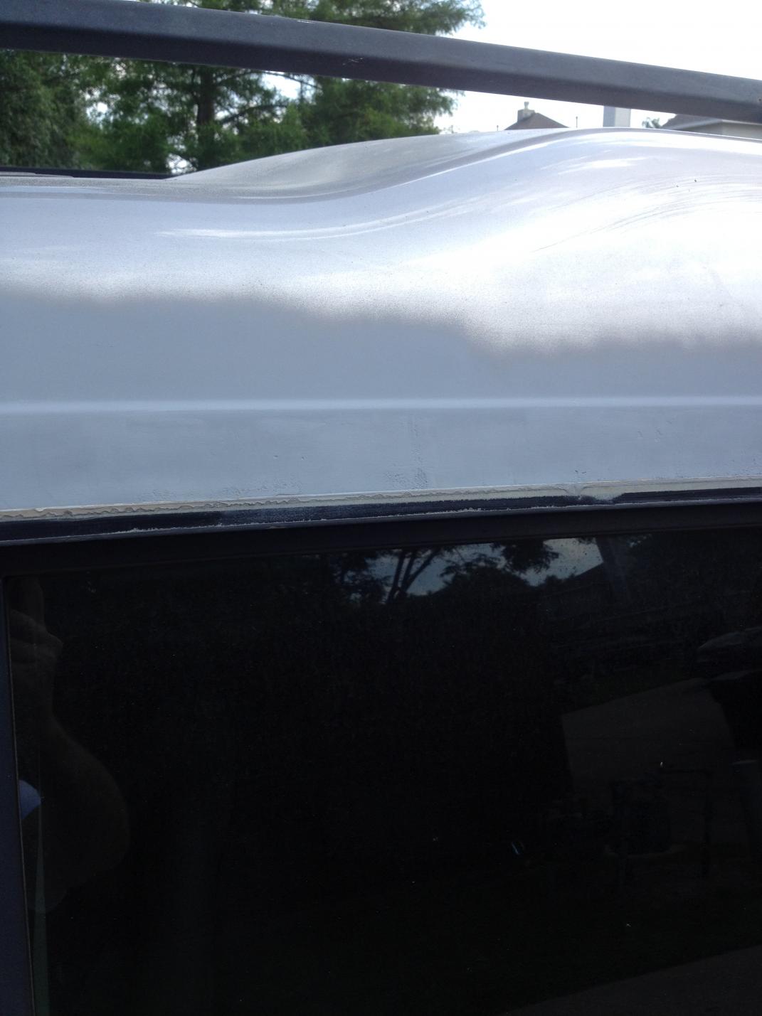

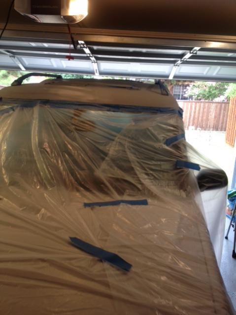

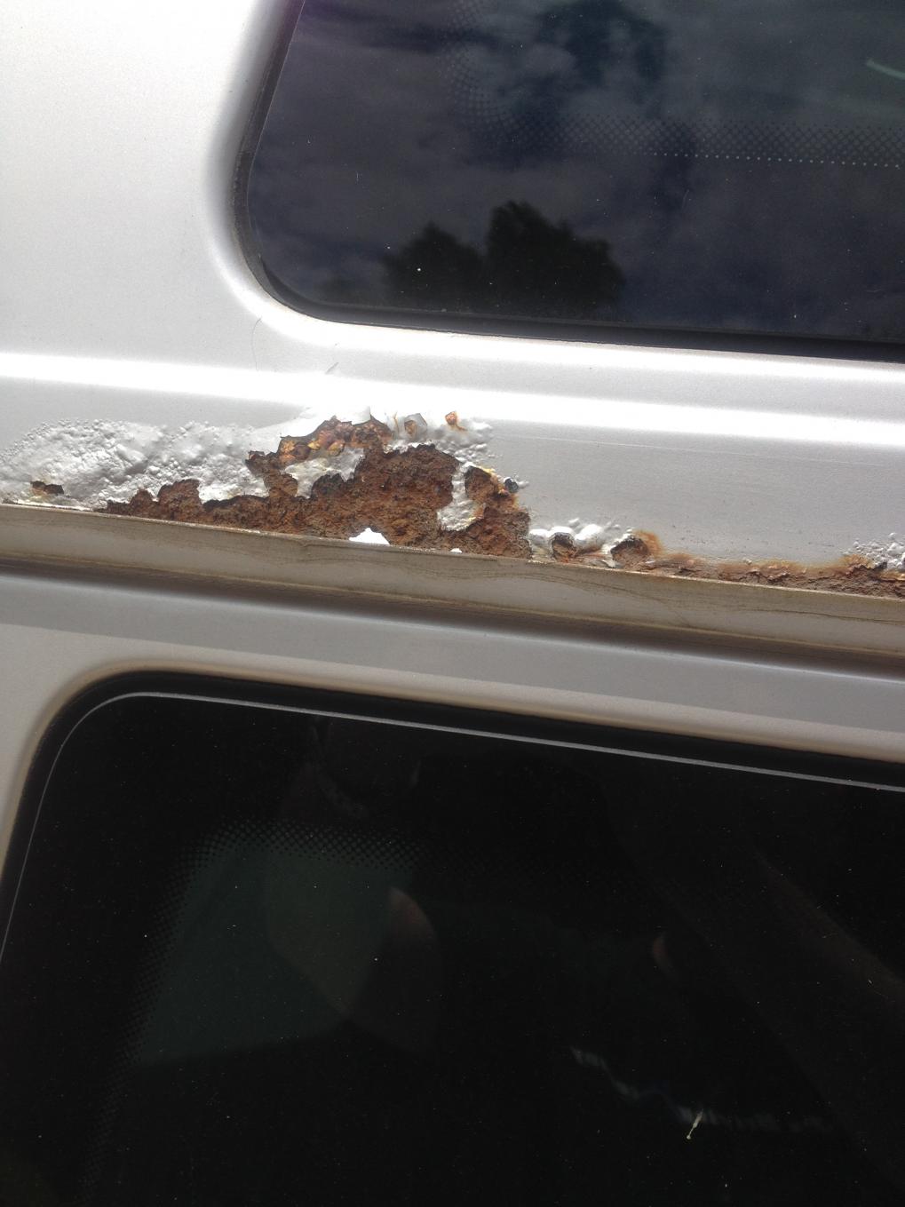

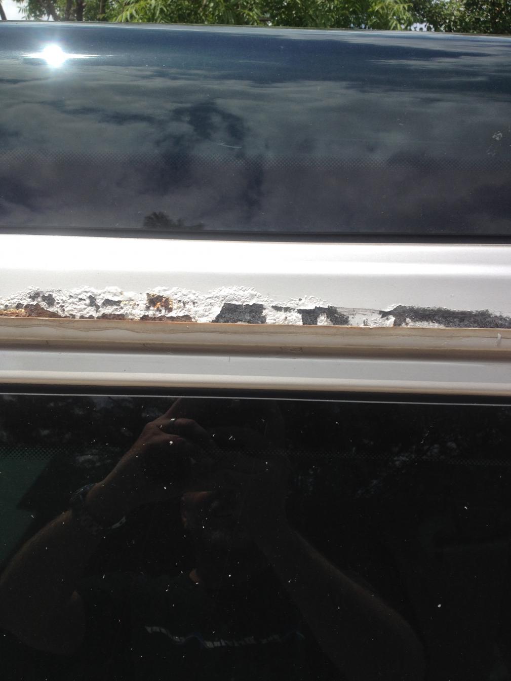

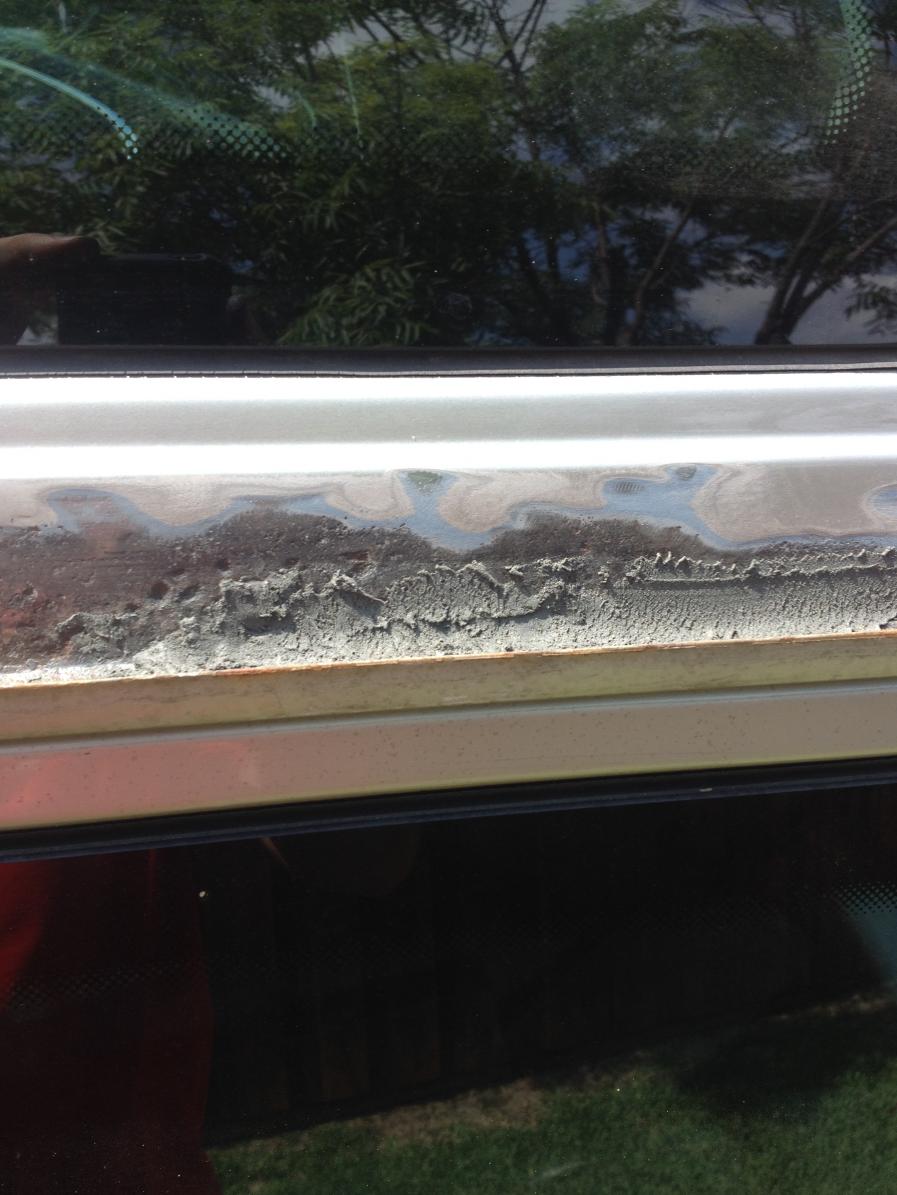

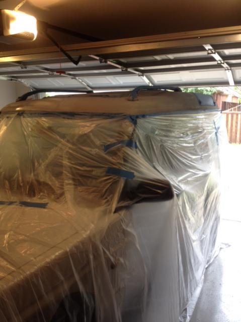

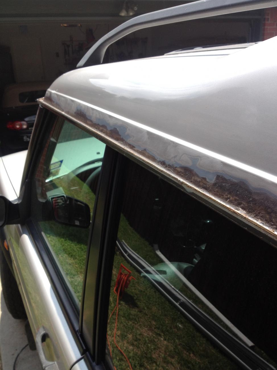

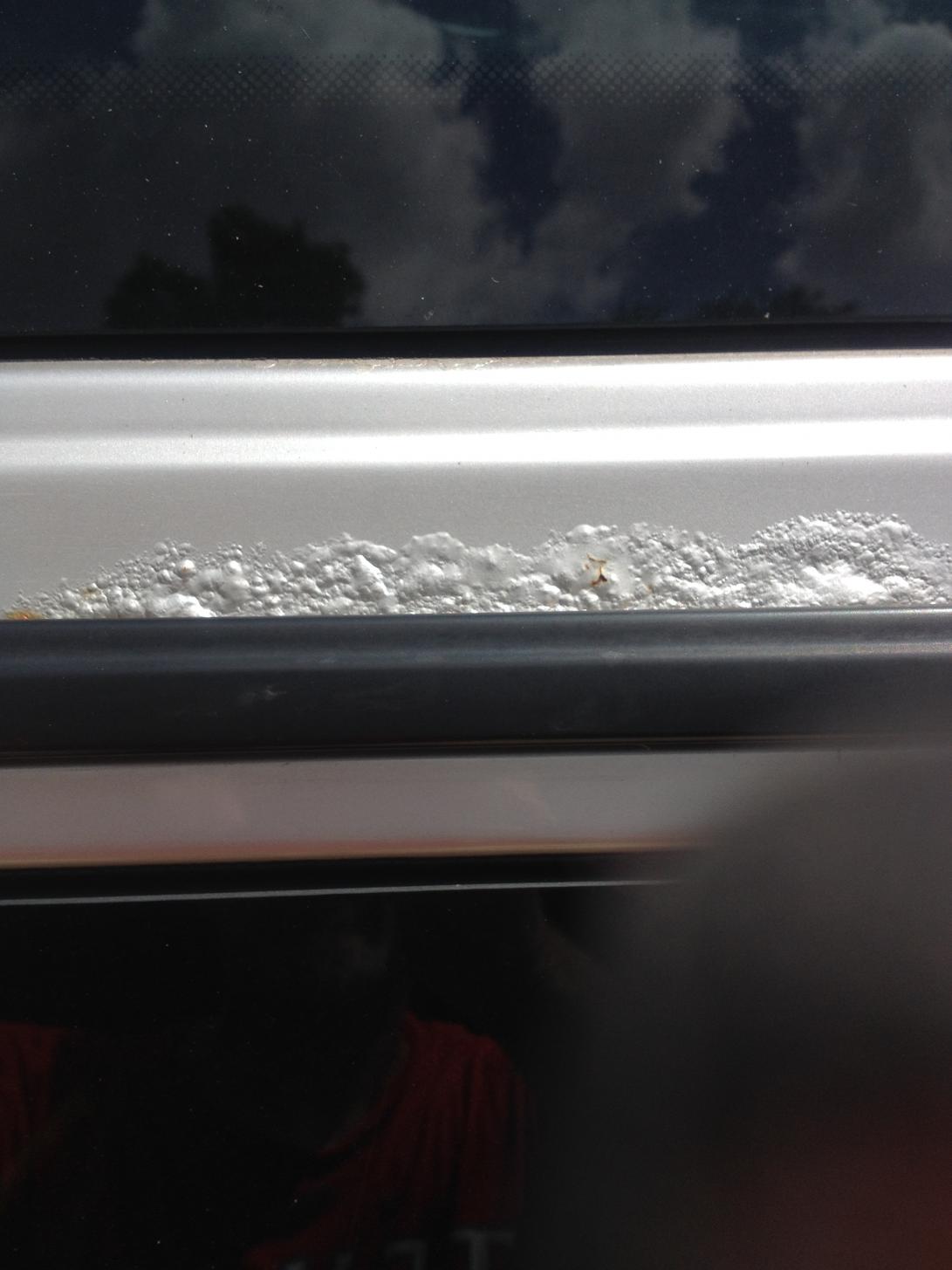

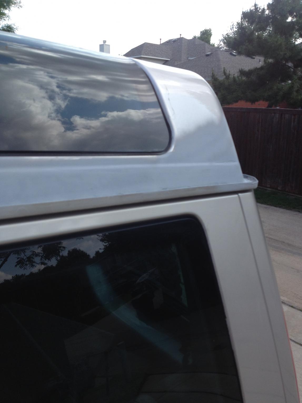

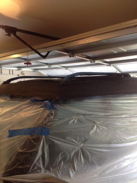

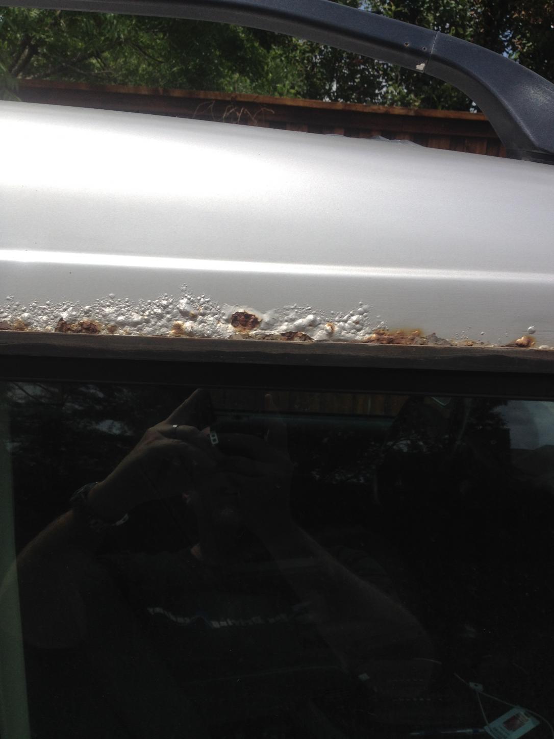

Started out with a bunch of rust along the roof drip rail line. Then the top got beat up in a hailstorm. I decided to try my hand at body work. Ground out all the rust, had to use some JB weld to fix some metal "holes", did a bunch of bondo and sanding and it ended up pretty decent looking. However, there was no way I was going to get it good enough to repaint, so I decided to go with black truckbed liner. I have to say, I really like it. I used Raptor Liner that I ordered from Amazon (about $120 and came with the gun to spray it). 4 cans of the stuff and I only used 2 on the roof. I'm going to spray the fender flares and plastic trim below the doors also. Overall - I like the look.
