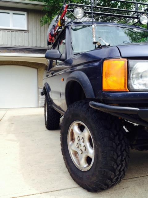

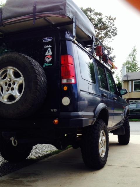

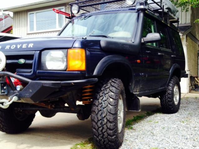

I just picked up a set of Super Swamper Irock ND's They are 265/75/16. Here are some photos for anyone wondering how they look.
My truck has a 4" lift, stock, wheels with no spacers.
These tires are surprisingly quiet on road. Frist 4x4 trip is this weekend, can't wait.

Looks great. Is that a hot tub on your roof?

What springs/lift/shocks are u running. Looks awesome

If it was a hot tub, I'd probably get better milage. Not, it's an RTT.
Lift breakdown:
Britpart HD 2" lift springs
1" body lift
.5" spring spacer in front
1" spring spacer in the rear
Rancho adjustable shocks all around
Front end has RTE shock relocation mounts.
