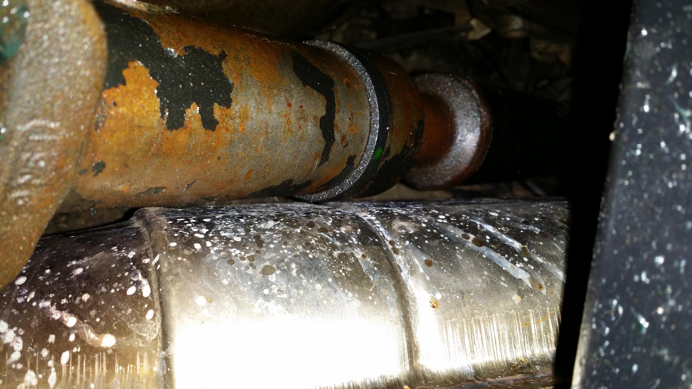

Originally Posted by martin12
Also the passenger side cat is roughly an 1/8" from the driveshaft, is that normal or is that what happens when you buy a direct bolt on? Anyone got any ideas
Either your motor mount is broken or your Trans mount is broken. It happened to me eventually the twisting torquing motion of the motor under load caused the cat to interfere with the driveshaft and left a nice inscision in the cat.
I recommend replacing both motor mounts and the Transmount.

I guess a little off topic but in reference to the motor mounts. While I was putting on my exhaust pipe I was able to push the motor up with one hand. Does that mean they are bad or do they have some slack in the mounts. When idling the motor don't shake or give no obvious signs. I will take a picture when I check the sensors and post it, and go from there.

Definitely post a picture, but you shouldn't be able to raise the motor with your had. You shouldn't be able to really move it at all.

Well took a picture couldn't seem to get it to show what I was after. it's hard but there is a slight 1/16 to an 1/8 gap. I pulled it on ramps to get in an out easier so the gap is smaller at that point. I tried pushing the motor up and watching all that moves , looks like the whole suspension moves motor, radiator, exhaust and everything so guess the shocks are over due for an upgrade. Haven't switched the sensors yet plan to try it tomorrow.
