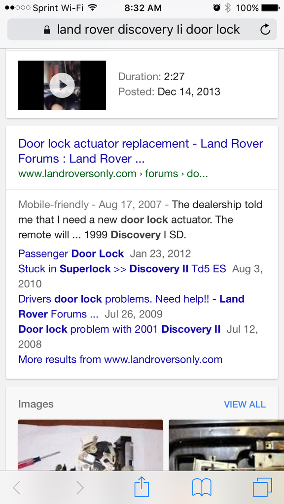

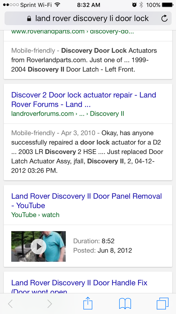

Welcome aboard! Here's a starter tip: check out the stickies up top and look at the major service 60k mile write up. That's a good start.
Second, what I do that's super helpful is using Google, let's say my door lock is broken, I search "land rover discovery ii driver door lock".
I look for the results listed for the various forums and start there:
Also, check out the "related thread" feature that is after the last post on each thread. Lots of times it's a similar question.
