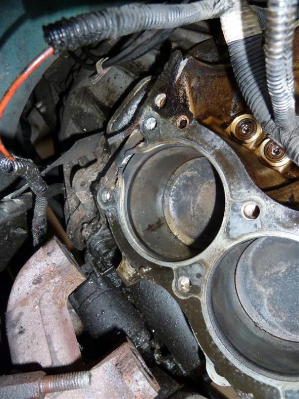

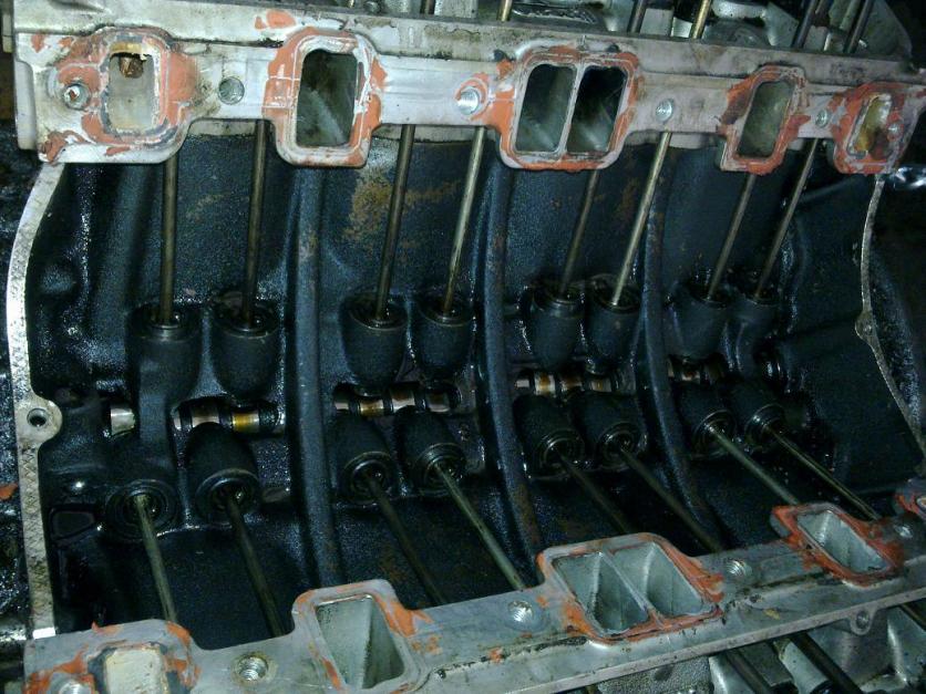

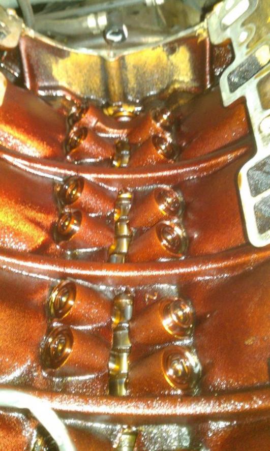

I have a HG leak on cylinder 3, out the side of the block just forward of the dipstick tube. Just did compression test (dry, TB open) and got 155 in cylinder 1 and 40 in cylinder 3. Not freight train, but certainly loud.
Pix of interal engine angles
Attached Thumbnails no compression on # 5 cylinder-100_2422.jpg   no compression on # 5 cylinder-hg-rear.jpg   no compression on # 5 cylinder-engine5.jpg   no compression on # 5 cylinder-03032011189.jpg   no compression on # 5 cylinder-30023360456_large.jpg
