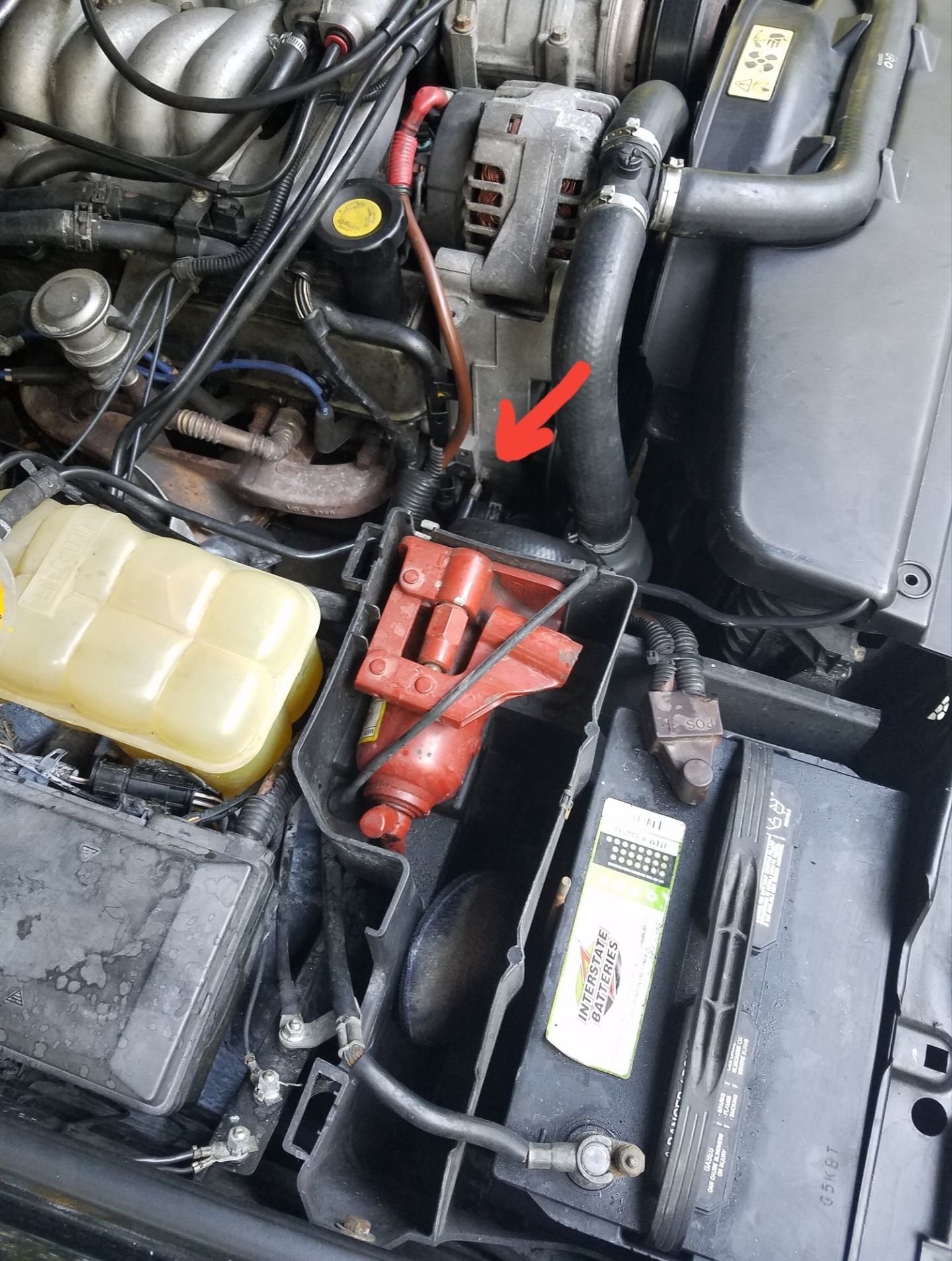

Had the same issue good battery voltage and car wouldn't start a few days ago figured it out to be this battery ground. Connection passed the wiggle test but a little tightening and she started right up probably should take it off and clean it but I'm lazy.
Thanks to whoevers image this is as I didn't have one on hand
