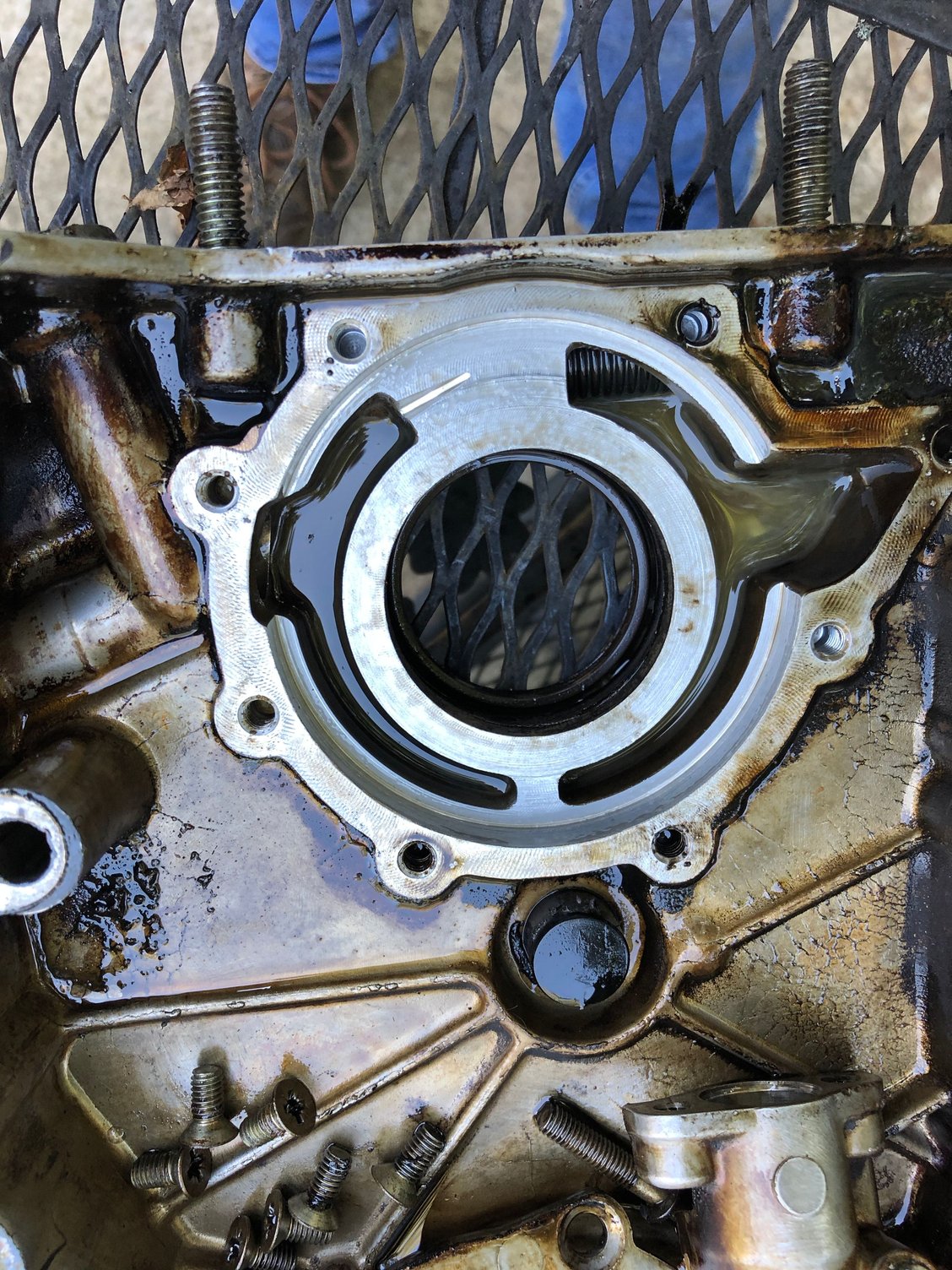

Got the front cover off
oil pump gears looked and felt good.
Got the oil pressure bypass valve off and the spring came out but not the little plug.
Once I fiddled with it and got it out .... oil started flowing!!!!
I think it was just stuck. I could have probably done the same thing with a light tap of a hammer without tearing it down.
If the bypass valve valve was stuck and not allowing g oil in that should explain the issue ..... right?
Safe to button it back up and give it a try?

Bypass valve is not your problem, it only functions to bypass the filter, the engine is downstream of that and creates the resistance necessary to have oil pressure. The bypass valve is on the filter side of the front cover, pressure relief valve is on the drivers side. Which valve did you remove? Where was it stuck? Bottomed or at the top of the tube?
I don't see any problems based on the pics.
The oil pump is very efficient and will actually work even rotating by hand, with it back on you can pull a cooler plug to make sure you are getting flow. You can also gravity prime through the removed plug, once rotating oil should pump out. Remove the spark plugs to make it easier. Once you have oil flowing, it should have oil pressure when running, even if it does have a walked cam bearing (oil pressure will be low if it has a walked cam bearing). If you do the LS series engine style air over oil pressure priming, you can actually get a oil pressure reading before firing the motor. The air over oil priming actually simulates the oil pump. Valve covers and intake gasket off you can actually visually see the oil flowing out around the cam bearings and rocker arms.
This is still a mystery for me, I have not seen anything yet definitive. Given you bought the motor used, fired it up, and it wasn't making loud knocking noises I wonder what caused the initial problem. Usually only mechanical failures cause loss of oil pressure.
Keep posting, we will help if we can.
