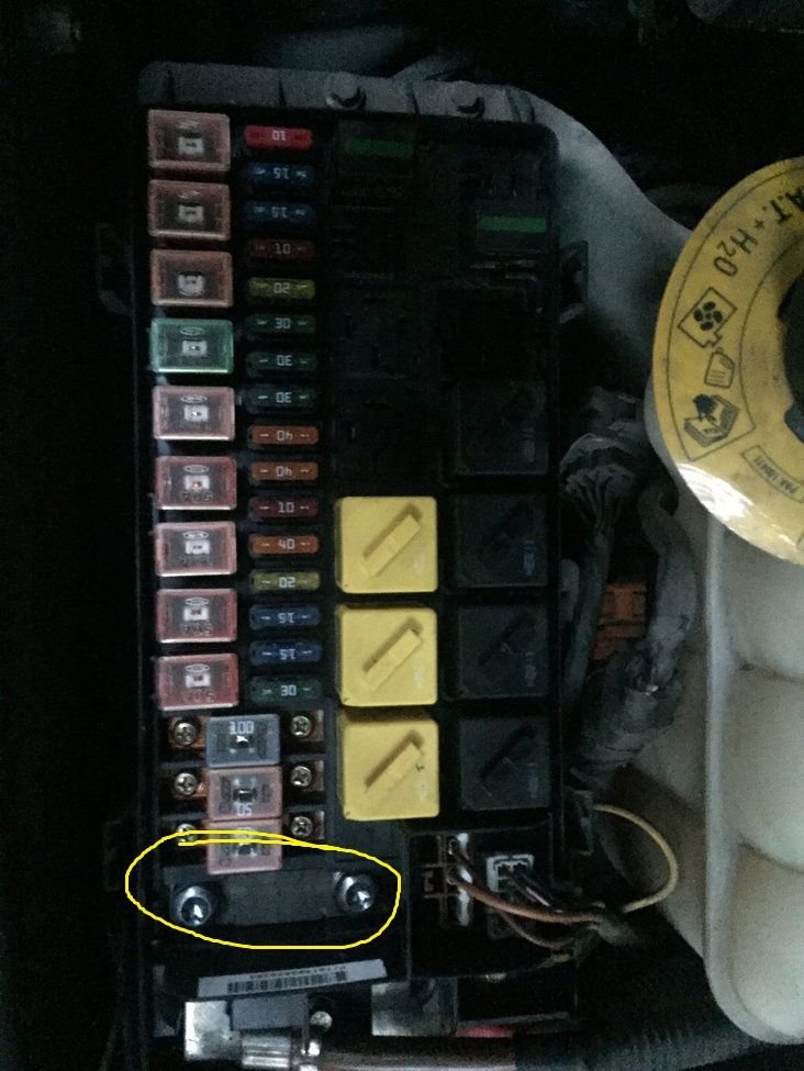

Old Jun 20, 2023 | 04:09 PM
signalMTB's Avatar
Joined: Aug 2016
Posts: 28
Originally Posted by branmanb2
Thanks for the help. Where is the 150A fuse? I have 3 fusable links that bolt into the fuse panel hnder the hood, but they are 100,50,50.
revived … anyone answer the question of where the 150 amp fuse is? Picture?
Old Jun 20, 2023 | 04:12 PM
mollusc's Avatar
Joined: Nov 2015
Posts: 3,560
Likes: 835
From: Staten Island, NY
It's the fusible link to the left of the plugs, at the bottom of the photo.
Old Jun 20, 2023 | 05:35 PM
Externet's Avatar
Joined: Jul 2012
Posts: 986
Likes: 158
From: Mideast US
Old Jun 23, 2023 | 10:55 AM
signalMTB's Avatar
Joined: Aug 2016
Posts: 28
This what I have circled? Presume I would put a test probe on one / either side? Running? Accessories only? Just curious of the proper procedure if anyone knows.
