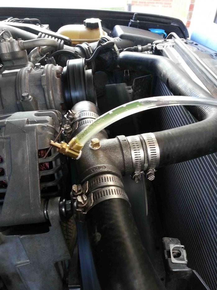

Here is another version of the home brew solution to the broken bleeder T.

I can put threads into the brass fitting looks like brass anyways our maybe put the bleeder screw into the T fitting on top of the fan shroud where it has a rubber end hose on it right now if the bleeder screw will fit which I doubt our I think the guy I bought my Disco from would have put the bleeder screw there. If it does fit I will have to cut off some of the metal on the T the one with the rubber end hose on it because right now its facing sideways. I turned it sideways when I got my Disco because he had it facing straight up and it was going into the hood heat shield. anyone know the size of the bleeder screw?

I would recommend staying away from URO hoses based on the reviews I have read. As for brass parts in the cooling system, that's what every sensor uses for threads, that's what the impeller in the upgraded water pump is made of, that's what the upgraded bleeder screw is made of and that is what the tanks on radiators used to be made of. I would just swap out the nipple in the tee over the radiator with a threaded plug if you are worried about the rubber cap and hose clamp setup.
